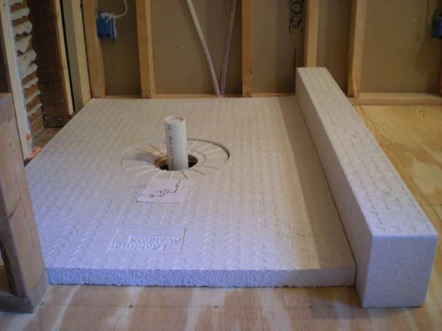

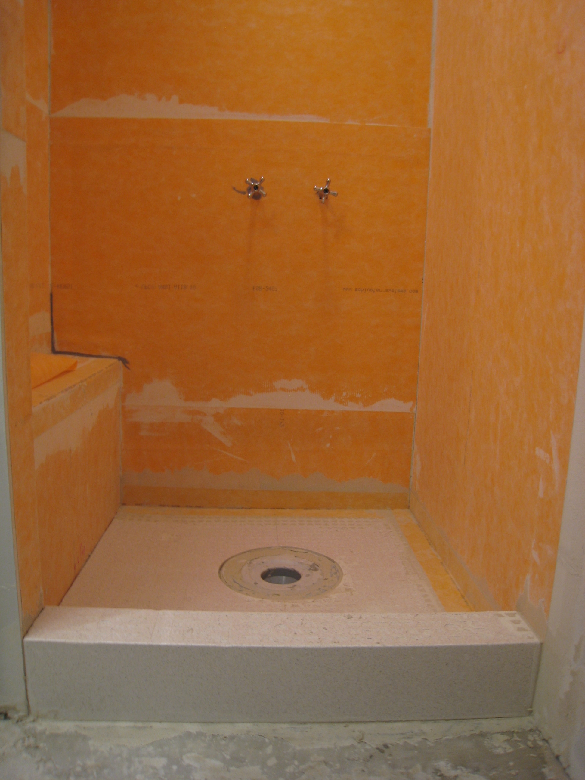

    I flood tested my shower earlier in the week and didn't lose anything over 24 hours. As a DIYer that made me feel good. Installed the kerdi over the schluter tray.
    But, 8 hours after I drained the water, the kerdi on the floor is still damp. I would have thought it bone dry by now. Most of the thinset seams are damp looking too (dark grey). Am I over thinking this?

    All dry now! And I used the Kerdi tray thinsetted on a level floor. The dampness in the kerdi on the floor is what bothered me. But given that I had no measurable drop in water over the 24 hours of flood test I feel good that there is no breech in the kerdi/thinse IMG-20140103-00054.jpg P1020790.jpg
    These pics are pre curb and flood test, bottom one is now, and you can see a haze over the kerdi, all dry.
