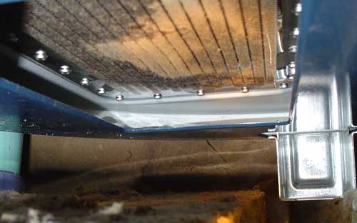

This 18 month old Whirlpool gas heater pilot light stays lit. When the main burner comes on, after two seconds, it clicks and shuts off all gas. I can immediately relight the pilot and the thermocouple lets it stay lit.
Watching it light, the main burner doesn't blow out the pilot, so I'm confused as to what's happening.
The bottom screen is clear, and the burner and pilot are clean.
What's next?

Is the water heater located in an attic, or some other extremely hot location?
Wherever it is, is there an adequate supply of fresh air into that space?

The heater is in the garage, which is shaded and not overly hot. It has been maintained properly and is clean and clear of obstructions. It is not in a closet or restricted space.
I have found that touching the thermocouple lead changes the behavior, and letting go restores it. Tomorrow morning, I will replace it and report back.
Sometimes the "filter" needs cleaning under the water heater.
1. The AIR INTAKE screen is small, and over time can clog with lint, dust, and hair.
You must clean the lint off from the bottom of the unit and from inside the heat chamber every 3 months or it will not get enough air to operate correctly.

And here's what it was...
During construction next door, they had dumped a pile of concrete rubble that had pressed against our wall. It had crushed the gas line after the meter, almost completely flat. There was enough flow to maintain pressure to keep the pilot lit, but when the main burner tried to light, gas pressure would drop too low and it would shut off.
Obviously, this was a narrowly avoided disaster :)
The utility has replaced the line and billed the neighbor with their consent.
