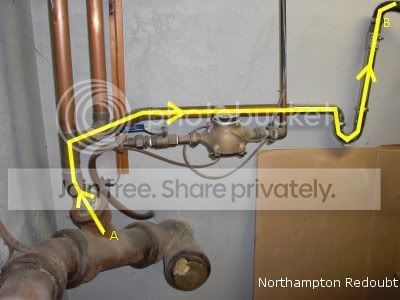

    Here give this a read. http://www.valleyadvocate.com/blogs/home.cfm?aid=9762 The home owner is blaming everyone but himself and his plumbing system for all the water damage he had gotten due to the city sewer backing up though his stand pipe, here is a picture that he had drawn in the yellow lines himself to show the path of how the water entered his basement. Now if he had installed the pump with the check valve and ran the washing machine to the pump his basement would have been dry still.
    [​IMG]

    An overhead sewer means that EVERYTHING on the below grade level SHOULD be pumped out. Without a pump, how do you remove water from the basement?
