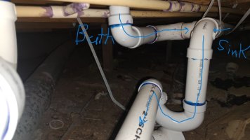

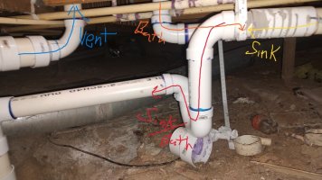

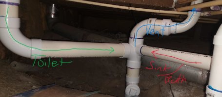

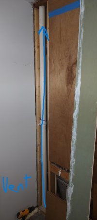

I have a very simple sewer line setup, it has venting issues. Need to understand where the issues are and how to possibly fix them, Would much appreciate help, been dealing with this for years and have tried a lot of options but nothing to do with reconfiguring the plumbing for it. Most sewer smell has been coming out of the tub but still seems like it might also becoming from the waste line going into the ground.
