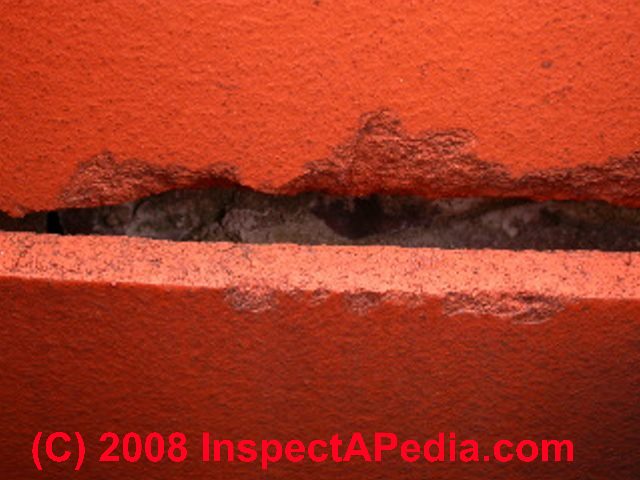

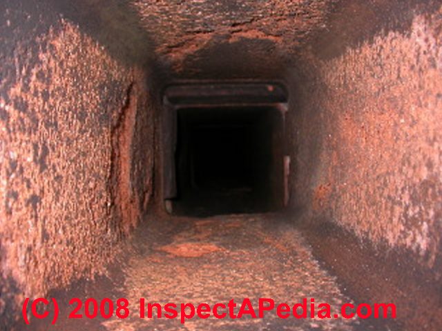

    In the process of measuring, hopefully you won't come across anything that looks as spalled & eroded as this:
    [​IMG]
    [​IMG]
    Look for things like loose brick or missing mortar, broken/spalled liner around the top of the chimney too, since that's where the flue gases are coldest, and most likely to have condensation issues.
