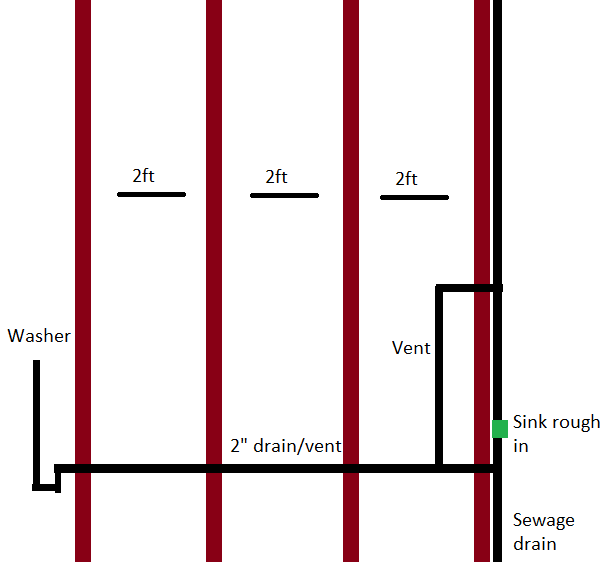

Hi all,
I'm in Canada, Alberta. I'm looking to get a proper vent on my washer and at the same time get a vent for my future sink. I was wondering if this was correct, or if the vent is too far from the P drain to be effective (and to code) as it is about 5' away.
Thanks for any help, I couldn't find the codes on this.. but I'm sure somebody here would be able to look at this right away and see if it's a garbage plan.
The washer drain is lower to the ground than shown below, but you can get the gist of it here.
