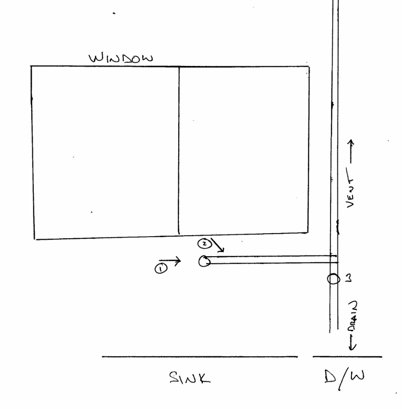

...You DO need a cleanout below the sink connection's "T", and that could be used to clear any obstruction in the overhead vent...
On that note, I've got a somewhat similar situation, but with the drain offset from the sink. Since the 'T' point will be behind a dishwasher, the inspector has suggested I add my cleanout to the horizontal arm, for easier access from under the sink cabinet (rather than having to pull out the dishwasher). I'm considering either location marked '1' or '2' as opposed to the standard location '3'.
However, as HJ noted, I've been under the impression that location '3' is used to clear blockages in either direction. A cleanout on the arm would only allow my snake to make the turn to clear the drain, not the vent.
So even if the inspector is approving '1' or '2', should I install a location '3' too, in keeping with best practice?
(FYI, the entire horizontal section is running out-of-wall.)
33,603
1,042
There is a window in the wall so that must be an exterior wall. In this area we would install the cleanout at position #3, but rotate it 180 degrees so it faced to the outside.
Speede541
164
Oakland
Hmmm... I'm hesitant to punch through my stucco for that since the inspector isn't asking for it, though it sounds like the cleanest solution. I think I'll err on the side of caution and install two cleanouts.
Thanks, HJ!
