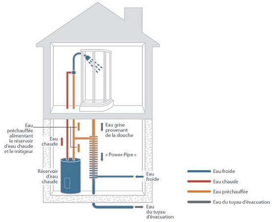

To extend showering time a drainwater heat exchanger might be useful for your situation. A 4" x 48" will return slightly more than half of the heat going down the drain into the incoming water stream, pre-heating it to roughly room temp. This means you end up mixing in about 2x the volume going into the cold side of the shower mixer, and taking a significant chunk off the hot side flow, and the recovery time for the tank is cut in half. (The PowerPipe series is the only ones currently listed on the MA-approved plumbing fixtures list, and you can get them at wholesale through EFI by opening up an account with them over the phone with a credit card. They can also be ordered direct from the manufacturer or Home Depot, but it's more expensive that way.) With six people it'll have a reasonable payback if they're all showering daily.

Drainwater heat exchangers are a section of copper drain pipe with a slinky of potable-copper piping tightly wrapped around it. To work they have to be oriented vertically- in a vertical orientation the surface tension of the drain water causes it to cling and spread to the walls of the drain for maximum surface area/maximum heat transfer. If horizontal the much stronger gravitational forces keeps the water on the bottom edge of the drain, at maybe 20% of the surface area contact. With 100-105F water going down the draing, and cold water coming in at the bottom of the potable slinky at maybe 40-45F, it exits the top at 70-75F. If both the hot water heater AND the cold feed to the shower are being fed by the output of the heat exchanger you get the energy-return benefit.
From a functional point of view it doesn't much matter how far away the heat exchanger is from the shower or hot water heater, but from an ease of installation point of view it's easier if the hot water heater is reasonably close to the heat exchanger, as it is with this tank HW heater:
So it may matter where your main drain stack lives relative to your potable plumbing. In most basements (even finished ones) it's usually fairly accessible.
Which is why in probably 90% of residential installations it just won't work.
Useful note. I think it makes sense to investigate whether we can put one in (if we end up going with a heat pump hot water heater, it might mean the difference between the Airgenerate ATI66, which has a Mass Save rebate, versus the ATI80, which doesn't), but I don't know whether it would fit - I'd need to verify where our drain line is.

Unless you have about a 4' vertical drop from your shower drain to the building drain (and almost nobody does) heat recovery won't work. I'd estimate 90% of homes just can't use it because there is almost never enough vertical between the inlet and outlet but maybe you can get lucky. Still, the cost of the equipment and having it installed is going to take a whole lot of years to pay back.
Really?
Is that 90% failure to install properly anything more than WAG based on nothing, a "90% of statisitics are made up on the spot", kind of deal? Do you have an example of at least a couple residential installations that didn't work?
Of those that I've seen personally 100% are installed correctly and work just fine. But it's a small sample set (less than a full handful), and I wouldn't presume to represent that 100% of residential installations work properly based on my personal experience.
Heating hot water with either oil or electricity at local MA rates there's a pretty short payback on drainwater heat recovery in a house with four showering adults and two children. When heat pump water heater options are being considered, the extra capacity of the drainwater heat recovery costs less than gaining showering capacity similar amounts with a step-size to a larger heat pump water heater. But also mitigates the recovery time issue (at any tank size), which is why I went there. The question had been whether it made sense to add an indirect to the oil boiler or do something else. My answer is "probably something else". It's not as if adding an indirect will be dramatically less expensive to install than a heat pump water heater + drainwater heat recovery unit, and the operational cost of the indirect will be dramatically higher.
Tom: The drainwater heat exchanger can live anywhere downstream of the shower. Most homes in MA have a full basement and the main drain is below the basement slab, and a section of at least 4' of vertical drain is all but a given. In crawlspace or slab on grade foundations I'd say fuggedaboudit, but he claims there is a finished (but not so insulated) basement here.

I think that once you start looking at Most folks basements you will find the vertical distance from the shower drain to the building lateral is rarely enough to install a DWR unit. Especially if the home is on a septic system and not city sewer. Typically there's 24" or less drop. I'm not saying flat out that it can't be done but it's not all that often. Also, I'd like to see some real numbers on the ROA for a unit sold and installed by a licensed plumber. I know what I charge for the installation and I'm fairly sure the ROA is a long way down the road especially if the shower is only being used a couple times a day by a couple of older people. As far as the heating system goes, his best ROA is to install the indirect and the intellicon and perhaps downfire the boiler slightly.
The cheapest DWR unit that Home Depot sells is almost 600 bucks and 72" long. The shortest is 48" and almost 900 bucks. Add 30% profit for markup! add all the other pipe! valves and fittings at probably around 200 bucks and then add a couple hours labor at another 400 bucks or so and then run the ROA
And that's a real conservative estimate because the chances of having 4 to 6 feet of un obstructed vertical stack are pretty rare. Usually Theres other drains coming into the line and if it's cast iron you can add a bunch more money to the installation because cutting the cast out and supporting the stack is going to run some bucks. If it was planned on a new installation it would make more sense. They claim 5 to 10% savings. If it's costing say 600 a year for hot water, times 10% that's a whopping 60 bucks. Against a thousand dollar plus installation bill? Still make sense? Other things to consider are the distance from the shower drains to the vertical stack. If it's a long way off the water will cool substantially on its way down the drain, drastically decreasing the efficiency of the unit. Oh yes and one more thing. A whole lot of homes don't have a 4" lateral. Generally it's 3" and only goes through the foundation 4"
