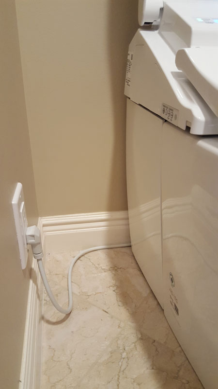

TOTO Neorest 550H in Redmond WA
When they give the rough measurements, they mean it. This rough was 13" and not the standard 12". The supply was 7" to the left of center, not the 4-1/2" they wanted, and a bit low.
There is hardly any give in the larger hose.
I picked up a split ring white escutcheon and replaced the polished brass.
