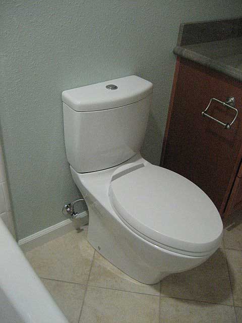

    Toto Aquia DF Installation Complete
    Hi,
    I just finished inmstalling a Toto Aquia Dual Flush Toilet. Many thanks to this forum and it's users for sharing their insights on the toilet and it's installation. I have only every installed one toilet before so I was very anxious about getting this done right.
    Once I removed the old toilet I had quite a job removing the old silicone. I had to restain the hardwood underneath where the old toilet was as the new one has a different foot print. I marked the holes with the template and predilled with the 11/64th bit. I installed the PVC trap and screwed it to the floor. I took the advice of another member and used 1/4" x 2 1/2" Lag Screws to secure the mounting blocks to the floor.
    I installed the bowl all the way to the wall which I realized after that I should have left a 1/4" gap. Once the tanks was connected it was touching the wall so I had to go back a few steps to try and pull it back off of the wall. Once the bowl and tank were secure we added the water and we only had a slow drip at angle stop. Once that was tightened up we seemed to be good to go. We adjusted the water level on in the tanks and adjusted the half flush too.
    Everything seemed to be going great until I sat on it wobbled.
    I tried adjusting the base screws with no success. At this point do I just shim it was a coin or two or do I need to take the whole thing apart and start over?
    Will the silicone seal help stabalize the toilet too? Should I shim and seal it?
    Any thoughts would be appreciated.
    I will post some photos too.
    Thanks a lot for this great forum and site Terry!

  7. jadnashua
    Joined:
    Sep 2, 2004
    Occupation:
    Location:
    Pennies, dimes, or nickels...cheaper and more readily available than running out to buy shims...

    Install just finished...
    First, I'd like to thank Terry and all of you for your comments and recommendations - they helped me not make any mistakes while installing the toilet. Things I learned this time 'round:
    1) The composite shims are located in the windows and door section of Lowes. The plumbing gents will look at you like you are asking for a left footed screw driver.
    2) Use a paper towel plug to keep the sewage gas out of the house. If you forget to pull it out before installing the rough in, one flush and it moves along, unlike the plastic bag I used several toilet installs ago.
    3) If you are installing on a tile floor, the blue granite bits by Bosch work wonders.
    4) The white screw anchors are a joke. Even if you drill 5/16" holes. I knocked mine in as far as they would go and then cut off the tops with a hacksaw blade. (It helps to rub a bar of soap on the screw threads to lubricate them and make it easier to thread in, TL)
    5) If the location of one of your holes is near the edge of the tile on your floor, the tile will very likely crack when installing the screws. Not sure how to get around this unless you drill a bigger hole in the tile.
    6) Duct insulation or a bit of hot water heater blanket wrapped around the plastic rough in quiets things up a fair bit.
    7) I didn't have leakage from the tank bolts, I had leakage from the filler tube. Props to Terry for letting us in on the sand the tank trick - it worked great.
    All in all, only a little more time consuming than installing the American Standard that lives in the downstairs basement. Wife hates that toilet because of all the grooves and crevasses it has.
