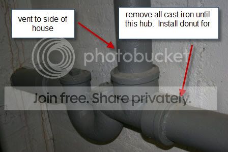

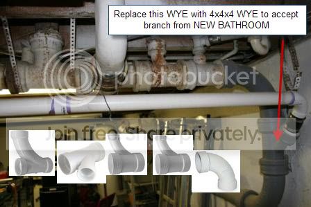

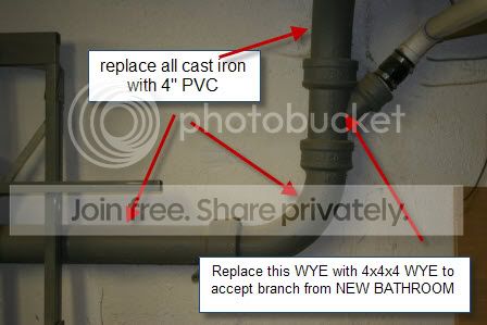

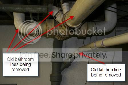

    So here is my problem. As you can see from the photos, my existing stack is cast iron. I need to tie a new 4" branch into from a new bathroom.
    My problem is that the new branch is lower than the current 4" PVC branch from the old bathroom. So I can't tie into the old hub. The old vertical WYE on against the wall is a 4x4x2. So I have to change that WYE in either case.
    So inclined to replace all off the cast iron with PVC up until the house trap as shown in the photos. My 2nd photo includes my suggested layout and use of new PVC fittings.
    If I do change all the CI to PVC, then I guess that I have the option to lower all the fittings and bring the new branch in right under the stack, instead of extending it to the WYE.
    I would appreciate comments and suggestions.
    How hard would the CI removal ?

    From one DIYer to another. Removing that stuff is a pain. Cast isn't too bad if u have a snap cutter and can break it into small enough sections that are easy to handle.
    I removed all mine bc i didn't want to have any old piping buried in the walls after doing a major remodel. I have 3 stacks in my house, 2 of which were 4" galvanized pipe! Your lucky bc that stuff can't be cut with a snap cutter.
    The pros of PVC is that if you do your own work at the house it is a million times easier to work with down the road.
    Since yours is in the basement you can easily get to anytime...
    One gotcha that I don't think anyone mentioned is that if you remove cast iron from below that stack the upper/vent side needs to be very very well supported or you will have hundreds of pounds of piping coming down on you fast.
    Some juristictions do not allow pvc below cast...FYI
