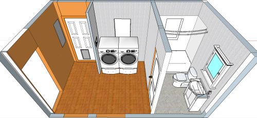

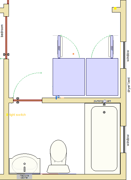

More detailed measurements and ideas
I know it has been awhile but I've been thinking about this more lately because my bathroom project is almost finished. Also, the laundry area being a cold zone made me think of it. I have sprayed grate stuff into more spaces around the back door but its still not keeping the cold out. I think I need a cat door that keeps the cold out better-- but I still need to put up wall panels.
Most of the wires for the electrical have some slack so things can be moved a bit, but I recently discovered that one of my friends is a certified electrician (although not licensed) and he will work for food (specifically Popeye's chicken). He did the wiring in his own home and had a licensed electrician watch and confirm that it was done properly.
I went back and got more measurements and details. My old sketches were pretty bad. In the new sketches I forgot to include the wall mount light on the north wall (on the east side) of the bathroom. It is above the medicine cabinet and has an outlet on its bottom that I think only one thing can be plugged in to. I don't know if it is a 2 prong or 3 prong outlet.
I also forgot to note that there are two water supply lines for the washer (I think one for hot water and one for cold).
Here is my latest sketch
Some notes:
*The yellow box near the 36" door on the east wall is a light switch. There are actually 2 of them stacked on top of each other. One is to the hall area and the other is to the former exterior light. The box for it is about dead center of the doorway on top of the door (I did not mark it on the diagram). The light was broken during hurricane Rita and we never replaced it.
*There is a light (I think fluorescent) that is above the medicine cabinet. I need my electrician friend to look at it because it blinks the bulb on briefly when I pull the chain, but then it just blinks back off.
*The bottoms of the windows start at about 46.5" from the floor.
*With the 15"H pedestals underneath, the washer and dryer are 53"H.
*The doors on the washer and dryer are reversible so I could switch their positions if need be.
*There is a shelf above/behind the washer and dryer but it is just barely hanging on to the wall-- I think it would fall if the washer and dryer were moved.
*I'm not quite sure where the plumbing for the existing shower is just yet. I'm assuming it may be in that side wall that I want to demolish.
*I believe the westernmost wall is load bearing but the one I want to remove is not.
*There is already somewhat of a door frame just before entering the laundry area. I'm thinking of narrowing it to 24" to use the existing bathroom door-- but I have other doors down in the barn that are wider and could be cleaned up and used instead. I would have to measure them.
*The ceiling fan is a small one that attaches to the ceiling from a rod.
*There is a toilet paper holder embedded in the east wall next to the toilet but I didn't mark it on the diagram.
*I'm not sure on the dimensions of the ventilight yet since I'm too short to reach and can't fit a ladder in there to measure. I think it is about 12"x13" or 12"x14".
*The ventilight doesn't work at all (none of the 3 switches do anything when I flip them) and I don't know if it is even hooked in to the ductwork or if it just vents into the attic.
*I have a friend who is a certified electrician. He also has experience building doorways & walls and will work for food (specifically Popeye's chicken).
*I was wondering if I could use an Air Admittance Valve for some of the fixtures to avoid having to mess with the vents, but I have read some negative things about them and I think they are not allowed in my state.

Plan A
Basically this would use the existing floorplan and just tear out the shower, patch the walls and floors, and maybe build some sort of storage around the toilet as shown in the previous post.
Because the pipes for the old wall-mount sink came up through the floor, they would interfere with the vanity, which has a drawer. My options to rectify this:
a) Bump the vanity forward and build something around the pipes on the sides and top (the back of the vanity is open). This would make things even more cramped in the room.
b) Move the existing drain and water supplies backward into the wall but leave an access panel for the shutoffs- this would only work if not over a joist and would require changes under the house).
c) Leave the plumbing where it is, but make a cutout in the drawer and bottom of the vanity to go around the pipes. This would reduce storage space and would be sort of a pain.
The laundry room would be left alone.
Pros: It is the least expensive of the plans and doesn't require much work and should not really involve changes to the venting. This one would leave more money for cosmetic fixes-- such as building a frame around the medicine cabinet to try to match it to the vanity and maybe getting a light that doesn't suck.
Cons: Lowers house value by not having a shower and still does not solve cramped laundry situation.
Plan B
This is about the same as Plan A but would involve rotating the washer & dryer clockwise and putting them against the east wall.
Pros: Bathroom- same as Plan A. Laundry area might have more space and it would be easier to access the front of the washer & dryer. It seems it might leave enough room to have some sort of wall-mounted fold-down table or some other form of storage.
Cons: Same bathroom cons. This would still leave unused plumbing jutting out in the laundry room. I'm not certain if there would really be as much room for opening the doors on the washer and dryer since both will be restricted by walls somewhat. The window will be blocked (although it is already partially blocked now). With this plan, the floor and subfloor in the laundry room would have to be repaired. I'm not sure if the power cords would reach the existing outlet so it might need to be moved. The drain for the washer might need to be moved as well.
Plan C
This one involves a lot more work and more money. The west wall of the bathroom would be completely removed. The north wall of the bathroom would be mostly (if not entirely) removed. This would leave more room for the laundry and make it easier to reach the washer and dryer. There might be more room for shelves and possibly for things to sort laundry.
Pros: Uses existing bathroom door (could possibly even recycle parts of the frame). Uses existing plumbing from old removed utility sink for vanity. Maintains value of home by having a shower. Doofusaurus will have his own bathroom to shower in. House guests will no longer have to go through bedrooms to use the toilet. There might even be enough space for a hidden litterpan. Might be possible to just put up shower curtains on long tension rods instead of having to put up walls for shower. Might be able to maintain vent locations and have less alteration to plumbing. Affords a little more privacy for toilet area.
Cons: More expensive and will require a lot of modification to the floor and plumbing. Might require vent changes in attic if ventilight and ceiling fan are swapped. Shower is directly under wiring for ceiling fan so the light would have to be relocated. Would have to walk through the shower to get to the toilet. Might be a tight squeeze depending on how the shower is constructed. If tension rods are used they could fall down unless there is something under them. No support of someone falls. Dryer duct will have to go through the wall into the bathroom (unless I can find a way to route it through the space in the exterior wall, but I doubt it). Vanity might have to be bumped forward or cut because of position of existing pipes.
Note: See Plan F below for alternate laundry layout.

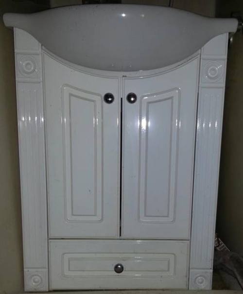

Oh, here is a better picture of the Euro style vanity
I wish I had the right attachment for my drill press to create the bullseye rosettes. I also wish I knew how to do the fluting.

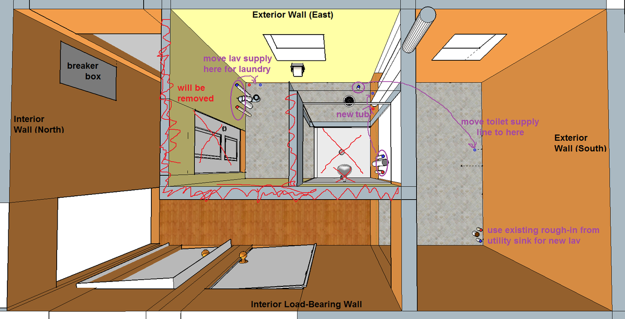

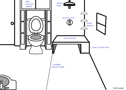

I got extremely bored and did a very crappy rough sketch of the bathroom if I were to do Plan E or Plan F.
I don't know if I would actually have space for that. And the door would have to swing outward to not block the light switch (unless the light switch got moved).
Please excuse my lousy perspective and scale issues. MS Paint is not the easiest medium for getting certain shapes right.
I think I would probably go with at least one linear drain for the shower. I would consider having a very thin partition between the shower and toilet. Depending on how much space either a glass wall, or a curtain, or (if there was enough room) glass brick. I'm thinking the drain would be along the north wall under the showerhead.
One thing I do wonder about though, is if switching the toilet and shower in location would mess up anything with how they tie in to the plumbing vent. If I understand correctly, the toilet needs to be the one that ties in closer to it than any other fixture? Or am I misunderstanding that?

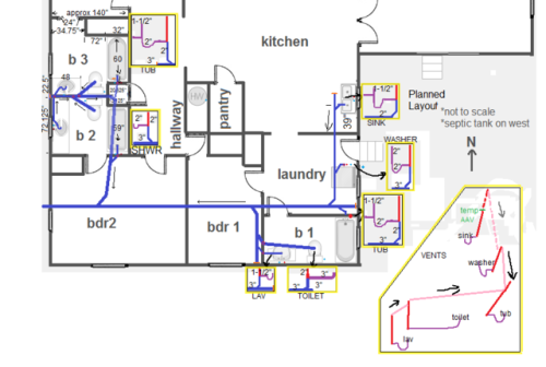

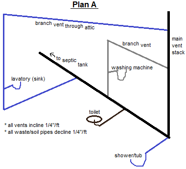

Plumbing Codes for DWV
WHere the toilet connects depends on how things are vented. The order is more critical if you intend to wet-vent anything there. You can always swap the swing of the door, if that would help. You'd need a new handle and lockset (maybe, depends - you can probably just reconfigure).
Thank you. I am just now seeing your reply because the forum does not send me e-mail alerts for some odd reason.
There is currently just a doorway with no door there, so I can just re-use the current bathroom door and have it swing whichever way I want. I might have it swing outward rather than in since there shouldn't be anything for it to hit when it swings out.
The plumbing vents are a whole other mess.
The vent stack that goes through the roof is right behind where the toilet currently is. I'm not sure how the rest of the fixtures tie in. I know the shower often reeks of sewer gas, but it may be because the trap dried up-- if there is even a trap under there.
This is somewhat how I suspect things are tied together now (but this is on the opposite wall of the theoretical bathroom so things would be flipped)
I at first thought I could do something like this:
but was told that was not right.
So I drew this, but was told that it also was not right-- but no specific reasons were given. I think I know why though. I think the air of the shower is still downstream of the toilet. Am I right?
I don't have a drawing, but I could possibly move the drain to the opposite wall but both adjacent walls are exterior walls. I could always bump the wall in (making it thicker) or add a bulkhead and add extra insulation and then have the pipes run up to the attic to merge with the vent stack-- or I could just route it under the house, up on the outside of the exterior wall, and have it go around the soffit like the largest vent stack on the side of the house.
I'm not sure if I would want the water to flow toward the shower bench or away. I considered a threshold linear drain where the shower is entered, but I think it would be unpleasant to step on-- plus it is farther away from the walls.
Am I barking up the wrong tree here?

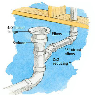

I've been trying to sort out the current plumbing code for my area. I'm getting confused about it.
And then I saw this online but its older.

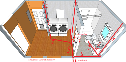

Just for fun, I did a mockup of an idea for the bathroom in Sims 3. The sims3 floorspace is larger than what I actually have to work with though.

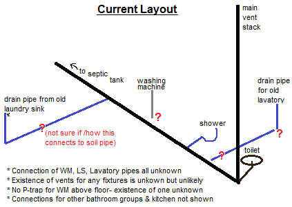

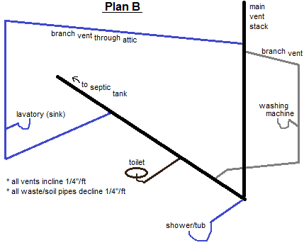

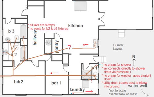

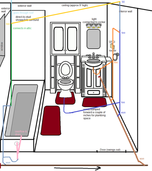

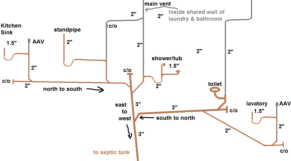

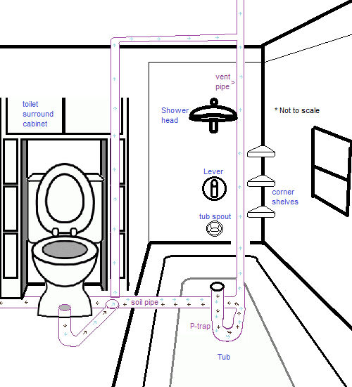

So, I've been doing a LOT of thinking about this and have also been trying to learn more about DWV systems to try to better understand how things work. I'm still not quite sure if I'm getting this right and I'm getting confused about upstream and downstream and if that mostly matters when wet venting or if its still important when venting normally. I looked at some of the drawings done by other people and figured out how to do a similar style. I've also discovered Google Sketchup 2014 but it would cost almost $200 to purchase the plumbing models for it. So I've been sticking to MS Paint for some stuff.

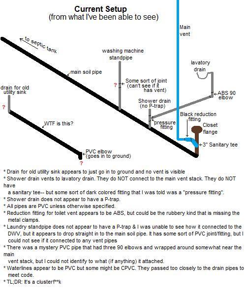

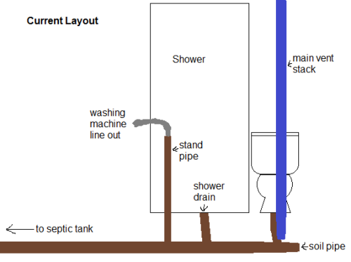

I did a rough layout of the plumbing (this is the view facing north from inside the current laundry room, if we take away the wall)
The stand pipe does not have a P-trap above the floor. I don't know if it has one underneath or if it is even connected to the rest of the DWV system. I've since learned that it needs a P-trap above the floor and the lengths of different segments above and below the P-trap are within a certain range- I have a diagram saved somewhere.
The toilet is the closest object to the vent, but it is the farthest one from the septic tank. So, that makes the toilet currently upstream of all of the other fixtures, right?
My latest drawing that is not to scale (I meant to have some length after the P-trap, but I botched the drawing)

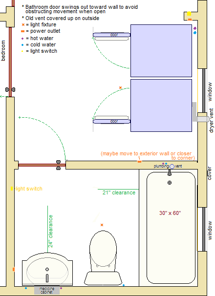

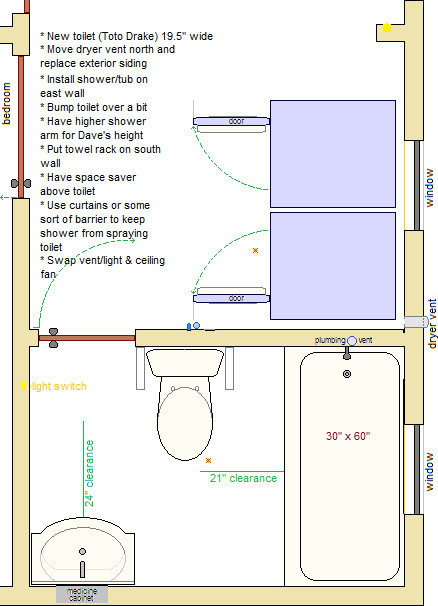

I realized that I think I can fit a 30" x 60" tub instead of trying to mess with a shower. This would allow us to fill the tub with water before major storms so that the water could be used to flush the toilet when the power goes out. It would also be less likely to overflow if clogged-- which I'm concerned might happen with a shower pan. The logistics of doing a curbless shower just caused me to ultimately rule it out.
Here is a rough line-sketch of what I know of the current layout:

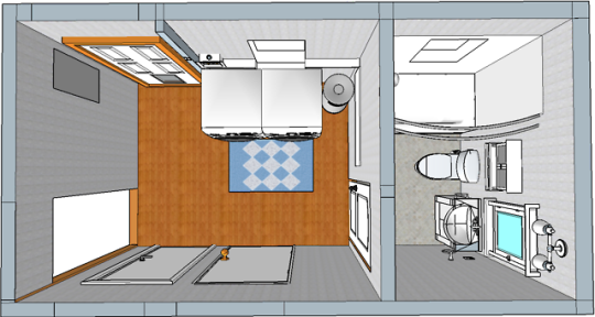

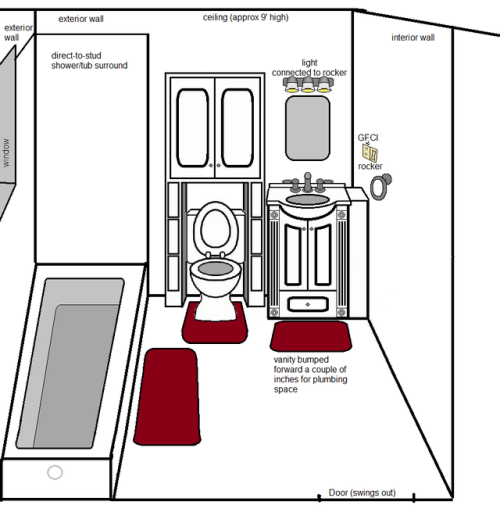

So, I scrapped my old ideas and have started anew. My current Plan A has the vanity where the old laundry sink was. The washer and dryer are flipped to the other side of the wall and the washing machine hooks to an improved standpipe not far from the original one. The dryer vent is moved northward along the east wall (I have some extra siding left over to cover the patched part).
Please ignore the text and green lines. I forgot to erase some things. I might not have the toilet bumped over quite that far.

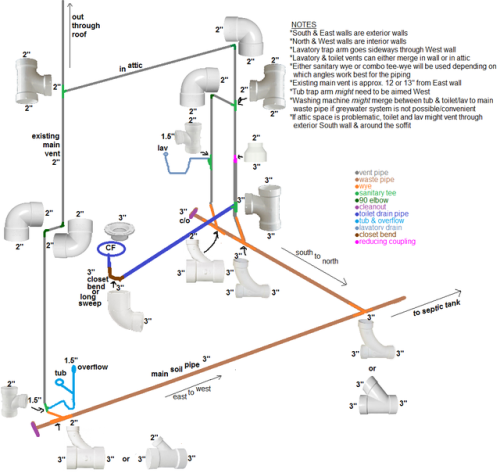

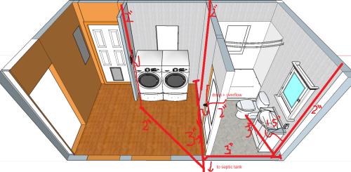

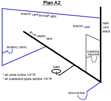

The not-to-scale rough line sketches of the plumbing:
or
One has the toilet upstream of the washing machine and the other has it downstream. I've considered finding out if its possible to get the lavatory to be upstream of the toilet but I don't know if that is necessary.

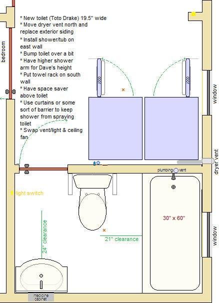

Plan B involves moving the washer and dryer to the east wall (which I think would give a bit more space to the hallway). The washing machine would now drain near where the old lavatory used to be. The water supply lines for the lavatory could probably serve the washing machine and I would get a proper washing machine outlet box-- which I intend to do with plan A as well).
Here are the line sketches:
or
I didn't draw the line sketch for another possibility involving putting the toilet on the south wall:
I would have to create a mockup with boxes to see how it feels to walk through the space with the toilet in different spots. I don't know if I would have room for the toilet spacesaver I wanted though, but that would be ok so long as the room as better flow and function.

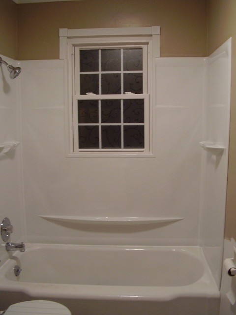

I want to get a vikrel or some sort of plastic (but sturdy) tub and surround and cut the surround to fit the window. This means it can't have any overly fancy raised design in the middle or it will look bad. My inspiration -- closest I could find to what I want-- is this:
But I would want corner shelves.
If you noticed the toilet is different, I sketched up an approximation of a Toto Drake.
The door swings outward to the east because if it swings inward, it won't have the proper clearance in front of the lavatory to not hit a person standing in front of it, which I've read is a code violation. It would hit the wall to the west with the doorknob if it went in to the west. If it went in to the east I would be concerned about it somehow hitting the toilet if it managed to get a wide enough arc. Swinging out to the west I thought it might hit the wall. So I chose out to the east where it is less likely to hit something and can get a wider arc. I found that the Habitat For Humanity Restore an hour away has doorknobs for $2.
I'm thinking of using vinyl plank in the hallway and laundry room (continued on from the kitchen) to withstand moisture and hopefully not tear like vinyl sheet. I plan to use vinyl sheet in the bathroom.
So, my questions:

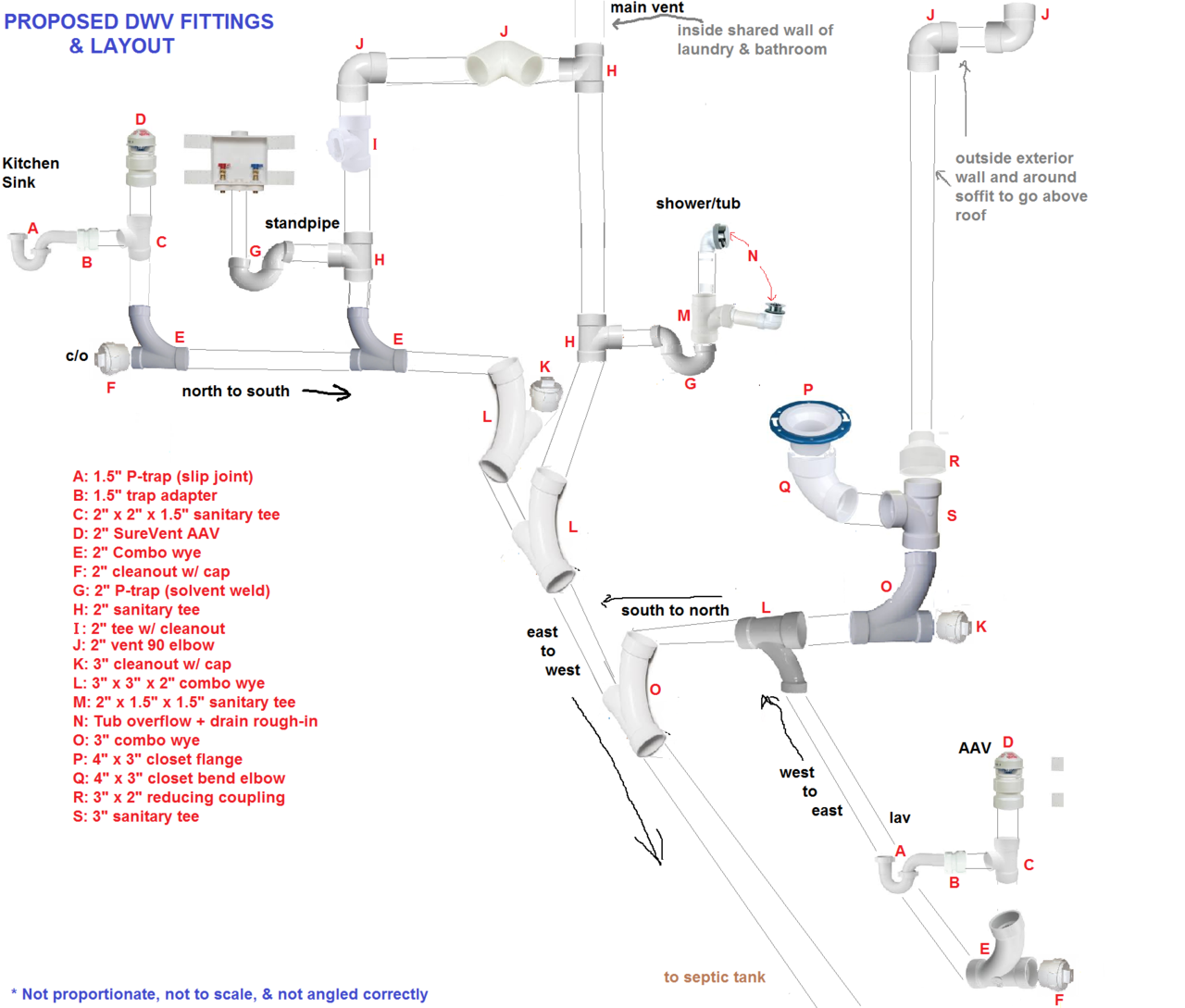

* Are any of my drawings feasible (to code)? If "No" to any of them, which ones and why? If yes, which one(s)?
* Which, if any, of the options do you think offers the best flow and least chance of problems?
* Where should my cleanouts be?
* What fittings should I use to hook it all up? (I know Sanitary Tees can't be used in horizontal position, so would I need wyes?)
* What wall material should I use? I know greenboard has issues with moisture and cement board is commonly used for tiling-- what about Wonderboard Lite? Or some other product that is lightweight and durable, but won't break the bank?

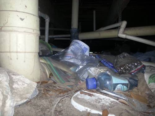

The bad news is, I took a look under the house and it was not good at all. I'm pretty sure the soil pipe doesn't even slope. Its partway buried in the ground. The existing shower has no trap and it vents through the drain of the bathroom lavatory and the lavatory has no vent. I guess that explains the sewer gas.
The toilet drain drops straight down with a tee and reduces with what I think is a fernco fitting without the metal straps.
Basically, it requires a lot of work even without remodeling. Note: except where noted, the pipes are all PVC. (the one from the shower looks like it might be dark green or black and is shaped like a T -- not a sanitary tee, someone told me it was a "pressure fitting")
Here's a photo of the fitting from the shower (there is no P-trap)
And here is the diagram I drew based on what I saw.
Here is my current plan (note the euro style vanity is 4" away from the side wall because I read that was code-- if its not required, please let me know)
As you can see, I moved the toilet to the south wall because people pointed out it would be awkward to have the toilet and sink on opposing sides and have to walk through that space. Also, with the current sketch, the door can be wider.
I still chose to swing the door outward so there is no chance of it hitting a person in front of the vanity if someone forgets to lock a door. Although I may play around and see how much space there is with a door that swings inward.
I'm not decided on the location of the power outlets. The electric dryer uses a different outlet than the washer so currently there are two different outlets behind the wall that I would have to move-- but they would be moved closer to the circuit box. I will still have to add a GFCI outlet near the vanity.
The vent for the dryer will actually go straight back but I didn't want to intersect the window in the drawing. The legend didn't show up very well in the image but the yellow boxes are light switches.
I have the dryer and washer bumped over so far north because I want to put something along the south wall to fold laundry or have some place to hang stuff.
The toilet paper holder will be attached to the vanity. Towel bar for shower will be on the north wall of the bathroom (although I'm thinking of getting one of those shower rods that has a second bar to double as a towel bar). I will have some sort of caddy or small cabinet above the toilet (but it will not be low enough to interfere with opening the tank for maintenance).
The toilet will be a little over 15" from center of toilet to side of vanity and over 16" from the tub.
Something sort of like this:
The main soil pipe (that carries waste to the septic tank from east to west) is about 6' to the north of the plumbing for the vanity. I am currently trying to figure out the best way to hook it up.
Something like this with the vent up in the exterior wall?
I would have the vent for the sink use a similar setup with a tee in the wall. The vent pipe would go up a few feet and then would travel east to connect to the toilet vent with the tee upside-down to allow the air to flow up.
I will have to add diagrams later, but here are some options:
a. The toilet and sink drains run straight north to connect to the main soil pipe with individual wyes (or combo wyes with that long sweep)
b. Instead of the toilet pipe going north, it would travel westward and merge with the pipe for the sink (with a horizontal wye) and then the merged pipe would travel north to the main soil pipe.
c. The sink drain pipe would travel east to merge with the toilet drain pipe with a wye and the merged pipe would travel to the main soil pipe.
d. (other suggestion from someone here?)
I hope this isn't confusing. Anyone have suggestions or feedback?

Ok. I've been told the last picture I posted is not to code. I think its because of the wye?
Would a 3" saniTee be better and then add some bends to make it go up?
Or would this be ok?
You can vent a toilet with a wye. It's the only fixture you can do that on, because the bowl siphons anyway.
The bowl is then refilled after being flushed by the fill valve.

This is a sketch of the house's current plumbing layout
This is an unfinished sketch of the proposed changes
Click here to see full size.
This is a rough sketch I did of what I would like the bathroom to look like if there is enough space (I suck at proportion / perspective)
And with not-so-easy to see notes on the direction of the pipes- the little red lines on the ends of the pipes are cleanouts-- I forgot to draw in the laundry hookup. I've also changed it to an inswing door because I went inside a bathroom the same size and found that there is enough room to open the door without hitting anything and if the door is locked, someone inside is less likely to get hit by it opening than someone on the outside of the door (if that makes sense).
Here is a list of the parts (although I need to make some changes and all of the 3" should become 4" if it turns out it's a 4" pipe main soil pipe).
Click here to see full size image.
I'm currently trying to decide the best way to tie in the washing machine-- I have a box I can use and put in a partial wall next to the exterior door. Is there a minimum distance from which I need to tie in the washing machine drain in respect to the other fixtures? I've heard something about too much force siphoning things and or having suds come up. I have enough of a space to do the washing machine standpipe without creating a crown vent inside the small interior wall near the door, but after that, I'm not quite sure if I should just tie in to the main soil pipe.
I made something in Google Sketchup
And the options for the washing machine drain:
(just replace 3" with 4" if that turns out to be the case)
So, any suggestions?

I putzed too long and the shower tub I wanted has been discontinued. I'll have to go with another one. I've decided not to keep the partial wall between the exterior door and the washing machine. Instead, I'll just keep about 4" of it to hold the existing light switches and have shelves of the same depth behind the washing machine and dryer. I'll have a table that can fold down against the wall when not in use that can be used to fold laundry when up. I've already found the appropriate hinges. I'm going to add an access panel to the tub/shower plumbing in the wall behind the tub (next to the dryer). Toilet and lav will be separately merged to the same soil pipe and the vents will merge 6" above the flood level. I have to replace the entire floor. I figure it should take a total of 8 sheets of plywood (graded to be used as flooring) with 4 on the lower layer and 4 on top staggered to prevent seam movement. I'll need to make it level & I'll have to fix what the idiot tenants did to the door frame. They took out the steel door, cut the door sill down so it is lower than the rest of the floor (allowed water to come in and damage the floor) and messed up the header. It is a full inch lower on one side than the other. So, I'll replace the header and make the doorway level and true. The cheap wood door the tenants put in is rotted.
My sketches don't show it, but I plan to put cabinets above the window & appliances. This will allow for more storage. I'm also thinking of having a small storage bench below the folding table.
This is the latest sketch:

Ok, I've revised it again. Someone pointed out that there will be supports and beams underneath the load-bearing interior wall. So, new solution is to use a 3"x4" closet flange with a 4"x3" closet bend and run it out from underneath the house (outside of the exterior wall just behind the toilet). From there the vent will go up and around the soffit and the drain will go down to a 3" combo wye with a cleanout on the end. I can cannibalize existing parts from a useless vent that was installed on the west side of the house. I can paint/cover the exposed PVC so it will be protected from sunlight.
Instead of running the toilet drain to meet the lav, the lav's drain will run west to east to merge with the drain for the toilet and I will temporarily use an AAV on the kitchen sink & the lav. I know it's not ideal, but it's better than having S-traps and the sinks constantly draining slow.
Here is a rough sketch/diagram. I've decided to go with 1.5" for the lav P-trap for better drainage and I will need to see what the options are to go from a 1.25" drain tail to 1.5" (I think there are some trap kits that have adapters/washers to make that work).
Here is the most recent diagram with the fittings shown and listed
One thing I am not clear on is what sort of tee to use for the washing machine drain line.
Would I need
1. A sanitary tee with a cleanout inserted in the hub?
OR
2. A DWV / test tee (no sweeps) that has a built-in cleanout?
If it is a sanitary tee, in what direction would the sweep be? I'm thinking up would make sense for a vent...
Additionally, I'm planning out how to handle the water supply lines. Since my existing cold water lines are PVC instead of CPVC, I want to remedy that. I'm thinking of converting both the PVC and CPVC to PEX. That will give me a little more wiggle room for lining things up. I will make sure to thoroughly insulate any PEX that is under the house.

I've decided that rather than running the washing machine's standpipe inside the wall, it will be under the shelf, up until it reaches the other side of the window. It will then have the drain & vent behind the dryer. The vent will go up & then horizontal just under some upper cabinets. I'll have a cleanout just above the level of the dryer's top. It will then go inside the wall next to an access panel, where it will tie in to the main vent & under the floor it will go at an angle to the main soil pipe.
I'm currently debating whether to use a standard tub/overflow kit type or if I should go with a direct drain tee & have the P-trap under the main tub drain with the overflow coming down to it. I think that might make more sense & would give more space for the trap arm.
I've purchased vinyl plank flooring (just in time bc it went up in price afterward) to go in the laundry room. It's 20mil wear layer & planks are 7"x48".
The end part will go under the appliances.
I'm going to have the power cord for the washing machine come up through the shelf & go over the plumbing box & plug in to the wall stub.

Major revision to the DWV part is in order.
As a note, I had the wrong wall for the shower supply lines. They were in the wall I wanted to tear down & they didn't have shutoffs below so I couldn't remove the wall without breaking them. They have since been cut off.
Some changes to my previous plan:
1. I am thinking of replacing the sanitary tee & reducing fitting with a single low heel inlet 1/4 bend with the inlet in vertical position (if that is to code-- still getting opinions on that).
2. I will have to put some 4" pipe between the closet flange and the bend to clear a thick beam running along the perimeter of the house under the joists.
3. I will be stacking a couple of boards & painting/sealing them to raise the toilet about 3" to make it higher (rather than buying a taller toilet since I already have a Toto Drake waiting for installation).
4. I am planning to but the vent for the lavatory through the wall instead of using an AAV. I'm still debating whether I can run it in the wall or just go all the way through and then merge with the vent for the toilet.
5. I will probably have to use some 1/8 bends underneath the sanitary tee that goes to the lav vent to get around the beam/floor support.
6. If I angle it correctly, I should be able to tie in with a wye instead of a combo wye.
7. I'm going to have to adjust the positioning of the standpipe's plumbing a little bit so it won't interfere with the dryer vent.
8. I might put up waterproof cementboard/drywall behind the toilet and on the adjacent exterior wall for more insulation from heat/cold.
9. I will add backerboards between the studs in case we want to add grab bars later on (I'm thinking of adding a 16" grab bar with shelf on an end wall to hold stuff and to be held on to).

This is the view of the east end of the bathroom with the custom rendered tub surround. It isn't perfect, but it was the best I could manage with my skill level. I know it looks cramped, but I've been in smaller bathrooms.
North side of bathroom showing the little shaving station w/ gfci outlet since it's near the shower (there will be double curved shower rod but I couldn't find one and am not good at drawing curves)
South view. I drew the mirror and vanity but I had to plug in and adjust an existing sink & faucet as I could not for the life of me figure out how to get the right curves for the shape of the euro sink.
Top view
Sterling Performa left drain stock photo
My MSPaint sketch of the Performa with window cut (it is one of the surrounds that is allowed to be cut)
