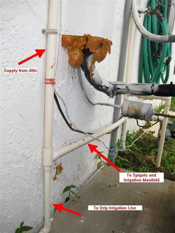

I've owned this house for just over a year and I'm slowly trying to correct the hackwork left behind from the previous owner.
The house is one floor built on a slab (in FL). At some point, there was a slab leak, so the house was replumbed with CPVC through the attic. It's a mess and clearly was not done by a plumber.

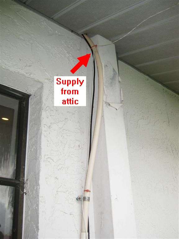

Lots needs to be addressed but most pressing is a CPVC supply that crosses the attic and exits the soffit to the exterior of the house. There is a huge bow in the CPVC as it exits the soffit and it's a failure waiting to happen. This line supplies a homemade (hackwork) irrigation system, two hose spigots and a drip irrigation system. This line bypasses the water softener.

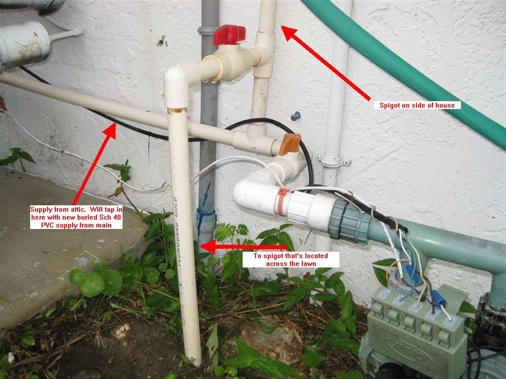

I want to tap into the main (it's PVC) just at it exits the meter and bring a buried 3/4" Sch 40 PVC supply around to the spigots/manifold. The meter is on the other side of a concrete driveway. I've found a guy who does contract work for the local utilities and has a "missile bore" so we can get the new PVC supply under the driveway.
It seems straight forward but before we start digging, I want to make sure there is nothing I'm overlooking.
All constructive comments are appreciated.

Thanks for the suggestions. The tracer seems easy enough. I was planning to go 12" deep. I'll see how hard the digging is. If it's not too bad, deeper can only be better.
Dumb question but is any kind of back-flow preventer required? If so, where would it need to be installed?

I believe that in all states, a tap into the main water source requires a Back-flow-Preventer. The type, location, and configuration does vary.
In that you are provide a source to a non potable use (irrigation) I believe you should have it.
I belive Florida does require sucha s ssytem to prevent a cross-connection between a public water system or consumer’s potable (i.e., drinking) water system and any source or system containing nonpotable water or other substances. An example of a cross connection is the piping between a public water system or consumer’s potable water system and an auxiliary water system, cooling system, or irrigation system.
Search the web based on your location. example attached: http://www.stcloud.org/index.aspx?NID=650

First CPVC can not be exposed to UV light. Pipe covering will solve that problem. You will also need a PVB back flow preventer and it has to be tested yearly. As far as running the line under the driveway, we have had very good success with washing the line under drive way. This is done by hooking a length of 3/4" PCV to a garden hose and pushing the line under the driveway. The soil down her is very sandy with no rocks.
John
33,600
1,037
line
1. EVERY irrigation system MUST have an approved backflow preventer when it is connected to a potable water supply.
2. Plastic water lines typicaly must be buried a minimum of 18" below the surface.

I'll research and purchase the necessary backflow preventer. I initially called an irrigation company for a quote to get the line under the driveway. They do something similar to what you suggest...using a water jet to create a void. I'm not too keen on this technique as it can result in the concrete cracking if the void is too large. The missile bore is mechanical and creates a well defined bore. The guy with the missile bore also has a utility conduit that 3/4" Sch 40 will fit nicely inside. This will help to prevent washout in the future should the line ever leak.
Once the PVC is routed, I'll either replace the existing CPVC with PVC or get it covered to protect it from UV. It's the crazy bow in the line that weighs on my conscience. I really want to get that out of the equation.
