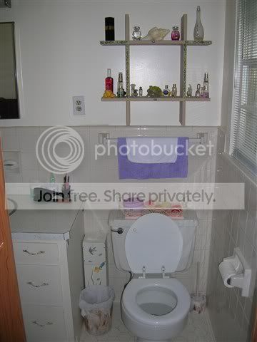

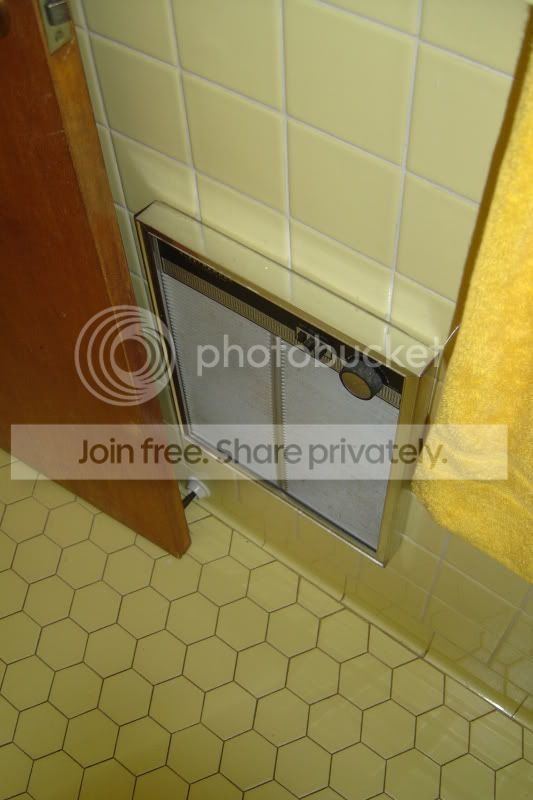

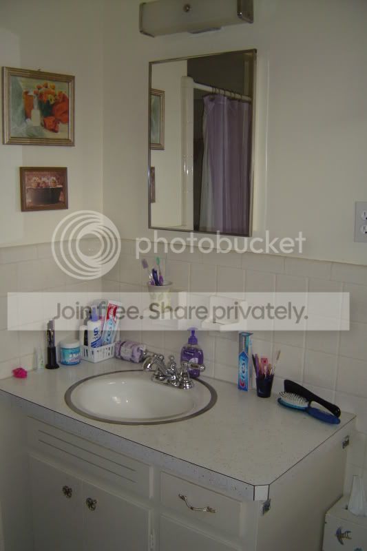

    I'm closing on this 1968 built home end of this month. One thing I don't like about it is the small master bathroom, not only because it's small, but the layout. Right at the doorway is the toilet. :eek:
    The current owners removed the door and put in an ugly accordian door. The way the bed will be in the room and with me sleeping on the left side, I'll be looking at the toilet, such a lovely view - worse off, DH can sit in there for a good hour and as much as I love him, it's just not what I'd like to wake up to in the mornings to see.
    So, I'd like to know, how complicated AND costly would it be to put the toilet where the vanity is and put a new vanity where the toilet is?
    I can tell you the house is built on a crawl space. I would think the move would be less than 3ft? :confused: I didn't get to measure the floorspace in there but I know the vanity is 41"w and the doorframe is 28"w if this could be of any help.
    If anyone has any ideas, or even alternate ideas, please post them. If you have a similar bathroom and have a pic, would appreciate the visual. My only alternative would be a pocket door, but not sure it can be done, the wall it would have to go in to has electrical on both sides and tile too.
    Thanks for any help, and Happy New Year to all!
    [​IMG]
    [​IMG]

    Probably not going to be able to do that. The move of the drain pipes in the crawl space would be a lot of work, but it is very doable.
    BUT, there are code issues. Depending on your local codes, there has to be a minimum of 21 to 24 " clear floor space in front of the toilet. I think the shower is too close. For that matter, there are codes about clear floor space in front of the shower, for safe entry and exit, so I think you flunk on both counts.

    If I put in a compact toilet and it doesn't extend any farther out than the vanity does, wouldn't that be okay? Or, put in a smaller vanity, width wise and have a little more space from the wall the shower stall is on to where the toilet would be placed?

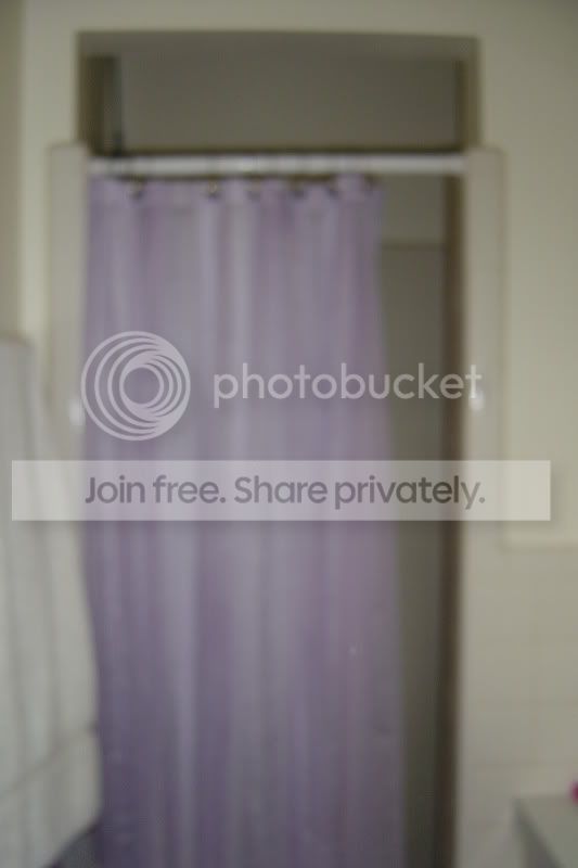

    Below is a pic of the space between he vanity and wall, sorry it's blurry. [​IMG]

    There are no really "compact" toilets. Usually the differences in length are relatively small and would not be a significant help. You have to remember that 15" from the center of the toilet to each side is required by code. Spaces in front of the toilet and shower have already been noted. One thing you might consider is a pocket door. They are a real door and don't require swing room. Moving the plumbing is the least of your problems.

    Right now...what is the measurement from the front of the vanity to the curb of the shower?

    Thanks for the input Gary. There wouldn't be a problem with the toilet being 15" either side, like I said, I wouldn't mind going a little smaller on the new vanity size. Also, with the pocket door, the wall it would have to go in to has an outlet on the bedroom side and a wall heater on the other side, similar to the one below (which is in the half-bath) While I wouldn't mind removing the heater, would need to keep the outlet on the other side. Also, not sure exactly what's involved when it comes to installing a pocket door - demo? [​IMG]
    Jimbo, honestly, I don't know what the measurement is, and won't know til the end of the month. Have to admit, I had no clue what a shower curb was, so had to look. At least through all this, I am learning some things:) I'm gonna guess by the picture I have, about 6"?

    You could rotate the toilet 90 degrees and put it against the left hand wall facing out towards the lavatory. A 24" vanity cabinet, or a pedestal lav in the right hand corner would give plenty of space. HOW you do it, would depend on how the pipes are installed and the way the house is constructed.
