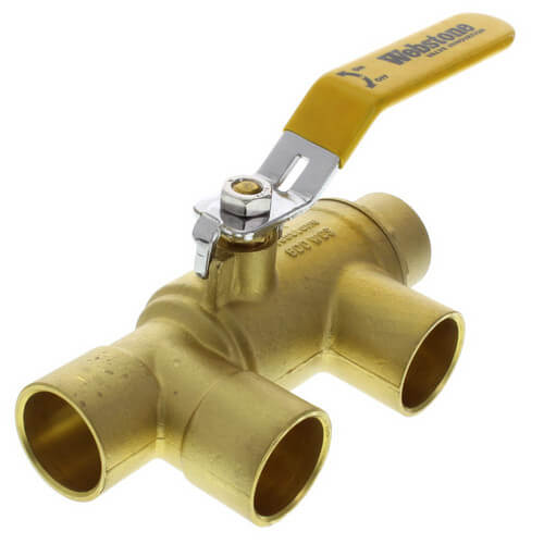

The pumping head of the coil in a toe-kick heater is many times that of a few feet of 1" plumbing or even 25' of half inch. You're not going to be able to fix this by swapping plumbing diameters.
Either pull the nipple between the tees and plug them, forcing the full system flow through the toe-kick heater (which could be problematic), or install a ball valve in place of that nipple to be able to raise the pumping head of that section of pipe (tweakable with the valve) just enough to get adequate flow through the toe kick coil. Odds are you don't need or want the full system flow to go through the coil, so closing it only partially to where the heater functions OK without reducing the flow on the whole system too much is less risky than turning it fully off.
One of these (called a "loop purge tee") will probably do the trick, and likely easier to retrofit than one built up with fittings (which would of necessity take more length, length that may not be available.)
