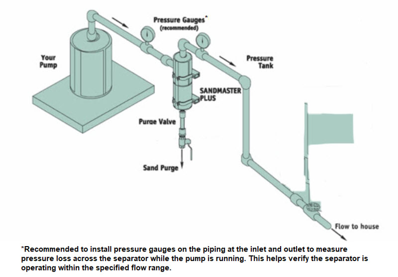

    My well (380') delivers crystal clear water with no odor. It has also passed several tests by a certified EPA lab for contaminants, bacteria etc. (most recently about 12 months ago). That said... I do have sediment... but it is more of a pain than a problem.
    I have two 10 inch filters in parallel "before" the pressure switch and tank assembly. (gasp) In reading thru these threads some people advise against this practice because of the potential of pump damage. My current setup is: pump>pressure relief valve>whole house filter>pressure switch>pressure tank>hose bib> house. By placing the filter first in-line it is also protecting all the well system components (valves, tank, switches) The idea of placing the pressure relief valve ahead of the filter it to prevent any pump or plumbing damage should the filter plug.
    Anyway, my sediment is so large (or heavy) that it typically migrates near the bottom half of the filter so the filter never clogs nor does it ever effect our water pressure. I got lazy once and left the filter installed for 18 months with no problem (never clogged.) The sediment has a gritty texture that feels like sand but is mostly black with particles of gold glitter (maybe mica?) Even without any filters installed (which I do sometimes) the screens in our faucets alone prevent the grit from getting past so we don't see any suspending particles in the drinking glass. (even letting a glass full sit overnight) no sediment. The pain is it eventually plugs the screens in my faucets and the holes in my shower heads and accumulates in the toilet tank.
    [​IMG]
    Removing the shower head and screens is no problem and I can easily flush away the particles.... which leads to my question.
    Because the sediment is so large and heavy I was thinking I could benefit from installing a spin-down filter, like a Rusco with a stainless or polyester screen... followed by a paper filter -with a pressure relief valve- after the pump but "ahead" of all the other equipment. Besides Rusco, are there other or better suppliers of Spin-down filters?
    The caveat is... (except for the pump) I'm getting ready to replace the entire system to install a pside-kick
    [​IMG]
    The instructions for the CSV state it should be the first device in line after the pump. My system has been perfect for the last 10 years (until the bladder in my pressure tank failed). Because my filter set up has worked so well... I was hoping I could leave the filter and pressure relief valve in the system ahead of the pside-kick as well as idding a spin-down filter.
    Any comments or suggestions?

    Just need to put the pressure relief and filter between the CSV and the rest of the manifold.

    One potential issue is can the sediment filter handle the head pressure when the pump/CSV is operating at a near-deadhead condition, like when the tank is in refill mode? The American Granby filter I have installed is rated for a max pressure of 150 psi. Besides the specs on the filter you need to look at the pump curve and pumping conditions (pumping water level, friction loss, etc) to confirm that.
    There may also be operational issues with the CSV if the filter plugs up, but others on this forum would know far more about that than I.

    Sorry... just to make sure i understand. As you know the pside-kick already has a pressure relief on the manifold just after the CSV. So are you saying I can insert a filter between the CSV and the rest of the pside-kick manifold?
    I guess my question was, will I be okay installing a spindown and sediment filter before the CSV as long as I install a relief valve ahead of the filters? Like this:
    pump> relief valve> spin-down/sediment filter> CSV> psidekick assembly> house
    (The idea being, this setup would serve to protect the CSV and the pside-kick assembly from the sand and gravel.) Now that I have the pside-kick and have had a chance to study it I believe it's an awesome design and will be the answer to my prayers for a simplistic - low maintence setup! . I just want to protect it from the grit that has played havoc on my previous well system hardware.

    Installing a 75 psi safety relief valve before (upstream) of the CSV would not be a good idea; it is very possible you will see 100 psi + while in low-flow or refill mode, even with a properly sized pump. Not enough pressure to burst the filter, but enough to blow-off the safety.
    Regarding overpressuring the filter, the Lakos Sandmaster filters are designed for installation between the pump and pressure tank. They use a metal pressure cylinder instead of the clear acrylic bowl that many filters use. With that design the pressure rating on the Lakos is likely greater than the Rusco, but I didn't confirm that.
    I did read somewhere that sediment can foul up a CSV ... valveman perhaps you can comment on that. I may have the same issue on my well when I install the CSV.

    First thing to consider is that your pump is the most expensive part of the system. The pump also spins at 3450 RPM and has very close tolerances. Sand and grit will quickly destroy a pump and motor. If at all possible, considering the size of the well casing, the best place for a sand separator is before the pump. A long flow inducer sleeve works good if the grit is heavy. The Lakos Sub-K http://www.lakos.com/products/Sub-K.html can also be installed on the pump itself. It flushes out the bottom and will eventually fill the bottom of the well with sand, but the pump and everything else is protected from sand.
    If the casing is not large enough or there is no extra hole below the pump for sand to fall into, then you cannot protect the pump from sand, you just need to filter it out before use. This Lakos separator is the one I am most familiar with and is rated up to 150 PSI.
    http://www.lakos.com/products/ILB.html
    Now as long as your pump cannot deadhead over 150 PSI, you can put this type filter or the spin down filter before the CSV. This will protect the CSV and everything except the pump from sand damage. You cannot put a pressure relief valve before the CSV, or the CSV will not function properly.
    If your pump can build more than 150 PSI, then you must put the filter after the CSV. Now the CSV will see the sand and grit, but that particular valve is designed to handle some grit or sand. The CSV is designed to leak 1 GPM when in the closed position, so sand damage that causes a ball valve to leak is not a problem for the CSV. Sand damage will eventually cut the guts out of a CSV the same as it doe the pump. However there are no screens or holes to clog in the CSV. The only movement in a CSV is the shaft moving up and down slowly about ¼ of an inch. So sand damage to the CSV is no where near as much problem as it is for the pump. If your pump will last 5 years pumping that much sand, then the CSV should last 10 years.

    Thanks for the feedback valveman... I went ahead and installed the Sandmaster before the CSV / pside-kick. As discussed earlier... many troubleshooting threads die off once the person resolves their intitial situation with little or no followup... so I wanted to close the loop.
    My final setup as follows:
    pump > Lakos SandMaster > CSV / pside-kick manifold > Big Blue 20" filter > House
    Setup has been in operation now for a little over two weeks. Constant 50lbs pressure. CSV working as advertised... and no pump cycling. Its been great! Now that everything is in place I have one last question... I plumbed everything, including the two pressures gauges as suggested by Lakos.
    [​IMG]
    I also installed a pressure gauge on either side of the Big Blue filter to give me a better way to monitor when the filter needs replacing. The gauge on the pside-kick manifold as well as both gauges on either side of the Big Blue filter are all reading 50 psi... but the two gauges on either side of the Sandmaster are both reading 110 psi! At first I freaked out. When I first saw 110 psi I paniced thinking the PVC feed from my well was going to burst. In an effort to troubleshoot, and eliminate the Sandmaster as a reason for the buildup, I took it completely out of the circuit. To my surprise both gauges still read 110 psi. Thankfully, a post I found in another forum helped ease some of my worry. It was stated the pressure build up is normal with the CSV. As follows:
    "The pump should build about 130 PSI max on the inlet to the CSV. That high pressure is not dangerous or going to hurt anything. High pressure actually makes the work on the pump easier and the motor will pull less amps, than when running at higher flow rates."
    After reading that comment and contemplating the fact I had 110 psi... my light bulb went on! All of a sudden I realised why you said "If your pump can build more than 150 PSI, then you must put the filter after the CSV" Whew.
    Anyway... after two weeks, no leaks and nothing has blown up yet. Now realizing my my initial fears were unfounded.
