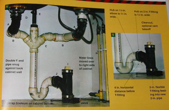

I'm planning to redo my kitchen sink soon, and I was looking in Rex Cauldwell's book on Remodel Plumbing and noticed that he recommends a completely different drainage setup than what I understand to be the norm.
The usual pattern would be to connect the sinks together with a T which feeds into the trap and then out to the drain line. Many of the connections here are done with slip joints. Cauldwell claims that slip joints tend to fail after a few years or if they get bumped, and he sees tons of rotted out kitchen cabinets as a result of this construction. He also complains that this pattern uses pipes which are quite narrow and constrict the flow too much. (And I have to admit that some of the T connectors I've seen do have only a 1/2 inch wide space at the intersection.)
Instead he recommends a drainage pattern where he uses 90 degree fernco connectors at each sink and connects to sch 40 1.5 inch pipe which he runs horizontally from each sink towards the back of the cabinet. He then runs those lines down the back of the cabinet, joints them with a Y fitting, followed by the trap, and then a final fernco connector to go into the drain. (Part of his goal is to get the drainage stuff back and out of the way.) Everything is glued together except the fernco connectors. He claims that these ferncos are less likely to leak than the slip joints, even in environments where the drainage gets bumped around a lot. If you need to open it up to clean out the trap or snake the drain you disconnect the ferncos.
What do people think about this alternate drain arrangement?

You will spend more money, but from your description his drain setup is a candidate for major drainage problems, and might not pass most inspections. You cannot use the Fernco 90's and would not want to even if you could. That is a "handyman" type of installation.

If this is a sample of his recommendations, then that is why I would throw the book away. All of that piping will accumulate debris. That debris will start to deteriorate and create an odor. When the odor becomes bad enough you will be coming back here wondering where it is coming from. That is the most obvious reason for not doing it. The other reason is that it will make a very bad drain.

I don't understand why this piping will clog more or accumulate debris faster than a standard drain. The standard drain has a 1/2 inch wide passage at the T. Surely that is going to be prone to clogging and will limit the flow rate out of the sinks in any case. My current sink drain is not a conventional one and I have to admit that when I saw the conventional one I was surprised by how tiny the passage was in that T.
The Cauldwell drain has a horizontal run from each sink. Why is that more prone to debris accumulation than the horizontal run between the sinks in a conventional drain? Then the piping is vertical which is surely not going to be prone to accumulation. And then you have the trap which is going to be similar to a regular drain. Maybe I should post a picture of his drain setup?
I would like to understand why his drain setup is worse than the standard one because to me (as a naive homeowner with very limited plumbing experience) it looks better, with the possible exception of it being kind of a pain to disconnect everything to clean out the trap.

I think I'll put up a picture tonight of the system.

I said I would post the picture of this drain setup. It can be seen for a few days at
http://members.cox.net/jsam/plumbingpic.jpg
As it happens this installation resembles mine: the drain goes down into the floor. I hadn't even thought about the drain coming out of the wall and how that would constrain the pipes. Is it possible for the drain to go into the floor and yet still be properly vented (the connection to the vent would be below the trap).

Hey, isn't that image from a book in the TimeLife series called "Crackhouses, Shanties and Lean-tos"?
Seriously, my friend, that's just not right.
No, that trap is not vented correctly, and it will siphon. One could argue an aav could be installed where the cleanout is shown, but, my gosh.

What state does Rex's "bio" say he's from?
wow that's not a legal install
I don't know what else to say but wow
different states have different codes.
Oregon can use furnco's (or our state inspector didn't fight me)
Arkansas allows me to put more than one trap on a trap arm.... so a 3 bowl K-sink will have 3 p-traps under there no end-outlet's....no room
but all states require vents
if he's going to print stuff for people to follow it should at least be legal in some state.
(1) less likely to leak? I've got no problem with slip joints leaking....
(2) faster drainage? I think that the "conventional" systems drain great.
(3) Out of the way? It's nice to have a little room between the drainage and the wall when you hav'to change out the faucet, or tight'n the soap dispenser when it leaks.
I use Fernco's in drainage on occasion. In commercial dishwashers and commercial disposals... In applications where the fixtures move... because they do flex and they won't break.
If you want to go ahead with this design I hope you do post pic of the finished result. oh and use no hub bands, not ferncos... they are better.

If he is a "master plumber" then I can understand why a lot of states are abandoning the designation. What is that "E" sticking out of the double Y? There is no vent for the trap. You cannot use the rubber elbows at the drains. You need a Mission, or BandSeal coupling at the floor. When the insides of all that piping accumulates a coating that begins to stink and the air starts circulating from one drain to the other THEN you will know why it is a bad system. If it were a "good" or even "marginally good" system, don't you think plumbers would be installing it so the customers would not have drain problems? Maybe you should request a copy of the errata from the book. Perhaps a revison or retraction of that drain system would be in it. I do not know of any inspector who would approve that drain configuration. And as far as the restriction in the standard tee, how much water do you really think the small openings in the bottom of the sink strainers are going to let pass through. You are trying to create a solution to a problem that you do not even have.
