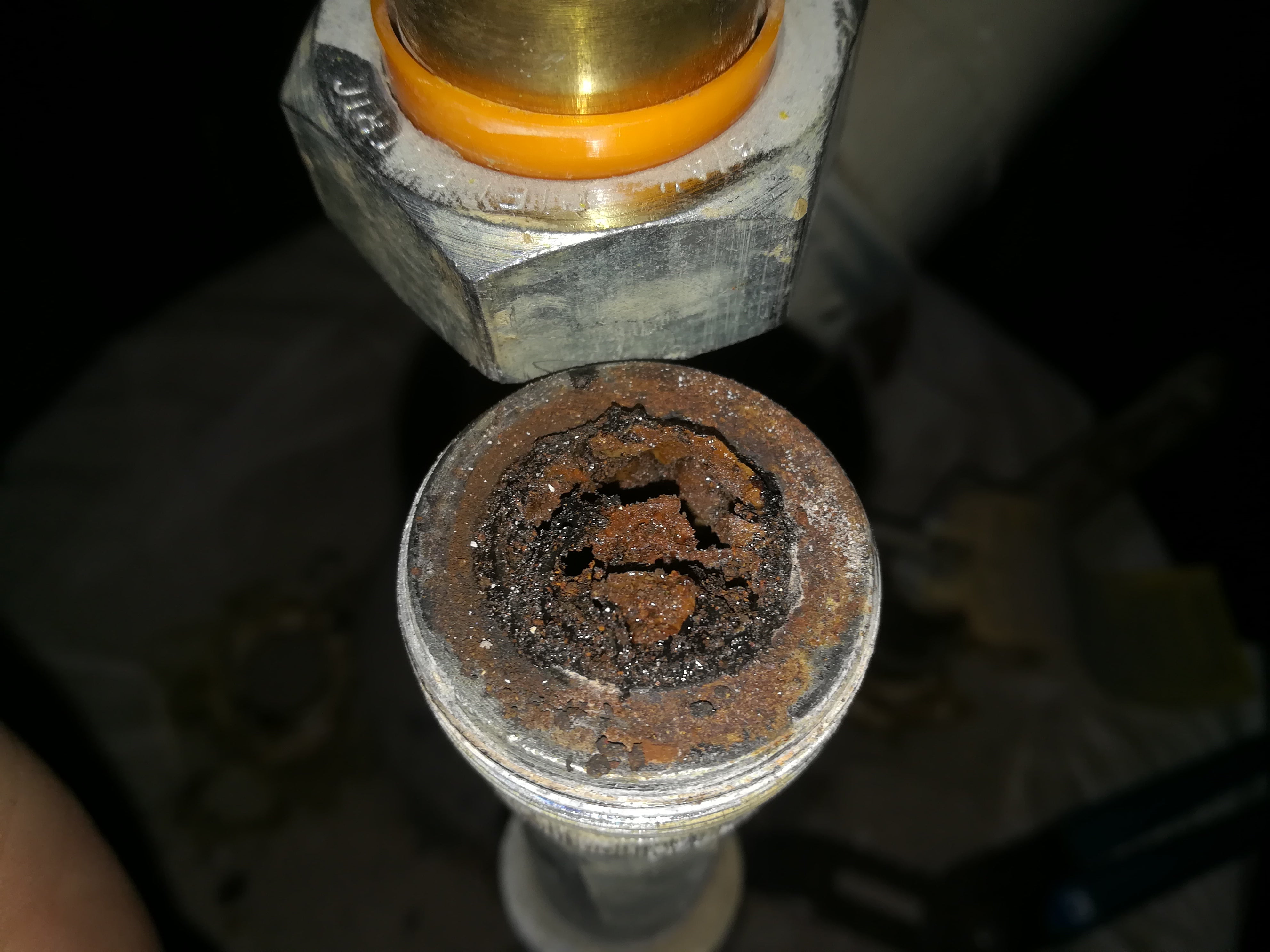

I lease a commercial space with heating and cooling provided by the building's boiler/chiller system. Recently, a leak developed in the hot water pipeline that feeds the fan coil unit (FCU) in my space. I've never been impressed with the quality of the work performed by the company that is contracted to do maintenance & repair on the building's HVAC, so I should have performed this repair myself. But I have had my hands full with several other projects, so I put in a maintenance request with our management company to have their contractor repair the leak.
After a month, the contractor finally came out and found that the leak was coming from a 3/4" dilectric union between the iron pipe from the boiler distribution piping and the copper pipe that feeds into the FCU. A few weeks later, the contractor replaced that dilectric union. The problem now is that the iron pipe and the copper pipe are no longer in alignment, as you can see in this photo:
It was not like this before the repair was made. I suspect what happened is that the contractor put a single large pipe wrench on the old dilectric union to remove it and pulled down hard to unscrew it (he probably hung all his weight on the wrench). This caused the iron pipe to rotate down at an upstream elbow, just to the right of the valve in the above photo. Below is a photo of the elbow, and I believe the contractor caused this elbow to rotate a few degrees clockwise, making it tighter.
The contractor spent a lot of time trying to get the dilectric union installed and, of course, it kept leaking because the iron and copper pipes were not in alignment. After a few hours of monkeying with it, he finally got the union to stop leaking. I told him not to re-insulate the pipe or close up the ceiling at the time (because I was not confident in the repair). Sure enough, after he left and hot water started flowing through the pipe, the union started leaking again. So he came back out the next day and monkeyed with it some more (uncoupled and recoupled the union, and probably tightened the crap out of it) and he finally got it to stop leaking.
It's been over a month now, and it's still not leaking. But the weather warmed up right after the repair was made, so no hot water has been flowing through this pipe since that time. I am not confident that the union will remain watertight once the cold season starts. Even if it doesn't start leaking in the fall or winter, I'm not comfortable that this joint will remain watertight over the years because it's such a hack job, with the union trying to seal two pipes at an angle. So I feel I should remove and replace it myself.
As you can see in the photos, there is another branch that tees off the iron pipe before the union, so I can't simply disassemble the iron pipe to re-align it. Besides, the elbow that was turned is upstream of the isolation valve, so re-making that elbow connection would require taking the building's entire boiler system offline and draining it.
So the question is, can the iron pipe be rotated backwards a couple of degrees (essentially loosening that elbow joint a tiny bit) to get it horizontal again? Or will the risk be too great of a leak developing at that old elbow connection? I've done a lot of plumbing work over the years, but I've never tried loosening a threaded pipe connection before to get pipes to align, especially not on a very old connection. Even though it would be only a couple of degrees of rotation, I'm not confident that this would be a good idea. If it truly is unwise, then how would you recommend fixing this misalignment between the iron pipe and the copper pipe?

I wouldn't want to risk rotating any of the big threaded piping. I would put a 4.5" or 6" brass nipple in and ProPress up female adapter and add a slip coupling if necessary.

Yeah, my gut feeling was that trying to rotate the pipe back to its correct position would be a bad idea, especially on a joint that is many years old. If that hack contractor had simply used a second wrench to keep the pipe from moving, I wouldn't be dealing with this crap right now. (Not to mention the mess he made of my walls, ceiling, floor, and the top of my commercial refrigerator.)
I'm not sure how the brass nipple would help with the pipe alignment issue. Also, I'm not a fan of ProPress, so I want to remove that ProPress coupling he used and replace it with a sweat coupling.
Probably the best solution would be to add an 18" length of 3/4" soft copper tubing in place of the rigid copper pipe after the union. The soft copper tubing could be bent to correct for the misalignment. The problem with that is cost: a 60' coil of Type L soft copper tubing costs over $700. I imagine it will be unlikely that I'll be able to source only a short section of 3/4" tubing.
Now that I think more about it, I suppose I could take a piece of 3/4" rigid copper pipe, fill it with sand, heat it with an oxy-acetylene torch to anneal it, and then use a conduit bender to put a slight angle in it.

Dielectric unions are not very good. They tend to fail even if installed in alignment.
If you are gonna drain the system and do the work just take most of that apart and re tape and dope the joints and put it back together with your preferred fittings. Brass nipple and female adapter to go from black to copper works. Stainless even better.

Ok, I now understand what both of you are talking about with the brass or stainless nipples. But I have to disagree with this solution. The purpose of the dielectric union is to interrupt galvanic (electric) currents between dissimilar metals: in this case, the galvanic current that is created when iron is connected to copper. The dilectric union does this by placing a plastic insulator between the two dissimilar metal pipes. Adding a brass or stainless nipple between the copper and iron can reduce the current by extending the return path through the electrolyte (the fluid in the pipe), but it does not completely prevent this galvanic current from being generated because both types of nipples are electrically conductive. (Also, brass to iron or stainless to copper are both disimilar metal junctions that will create their own galvanic currents, just not as much as copper to iron.)
That said, a more important reason for me to retain the dielectric union is because removing and replacing it with something else would change the engineered design of the system. If the piping later fails for whatever reason, then the building owner could, and likely will, hold me liable for the damages because I changed the system's design.
Btw, I will be replacing the cheapo dielctric union installed by the contractor with a quality dielectric union made by Watts.

That could have been an easy fix if the guy would just have
cut out more of the copper beyond that propress fitting . Heating up the copper
and putting a slight bend in it to line up better with the steel pipe
would have been the easiest way to resolve that issue... its called a "German Elbow"
their is no way I would ever fool with that old steel pipe

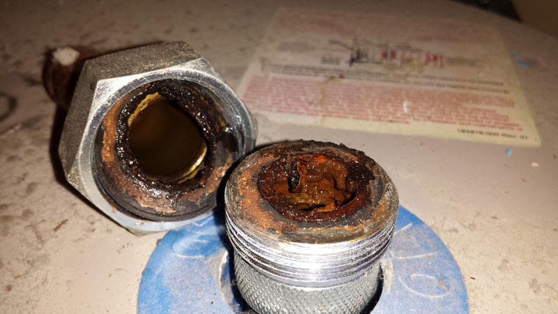

When school district specs insist on dielectric unions, I show these and tell them no dielectric unions or we walk off.
I totally agree with you...Dielectric unions suck.... I think they could have easily just installed a SS flex connector
on that situation and it would not have had the stress on the lines and it would have worked for decades.....
I have seen so much of this over the years..... I have found that SS flexible female connectors
seem to be the best option for water heaters and other issues...
basically the SS steel connectors are Dialectric on both ends of the fittings----
If you dont think this is true , could you please explain to me why it is not so??
You can see the nut and pipe have a plastic ring which breaks the ground ..just like a dialectric union does..
and the rubber grommet disconnects the line from the heater....

They aren't technically dielectric. They don't actually break the connection as the metal nut touches the metal connector which touches the water which touches the black iron pipe.
Being fully dielectric isn't that important if the connection is LESS conducive and MORE strong. The problem with dielectric unions is that the corrosion and electrolysis is super concentrated on any part of the galvanized metal that has any type knick in it. So if there are any exposed threads in the union (which there always are) the corrosion focuses it's action there. It's mostly the oxygen in hot water systems that make dielectric unions really bad. Oxygen which isn't present in boiler systems.
The gaskets and weakness of those connections are what's mainly bad here.
They make dielectric nipples in any size for this.
