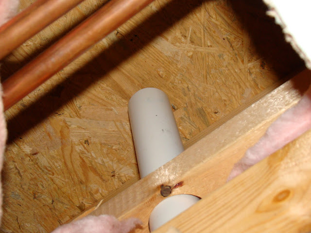

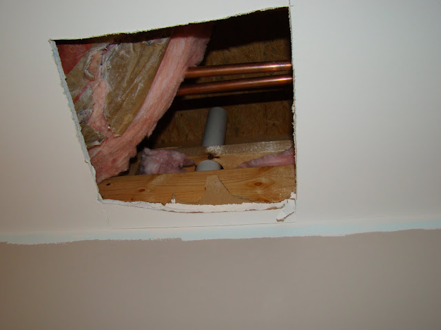

Ok so I thought maybe the smell was coming from the ceiling so I removed the light/vent fan. It stinks in the ceiling too! Also the vent fan was just venting right in the ceiling. What does this mean? Do you think they just stubbed the vent pipe off in the wall or in the ceiling area? Any ideas?
AndyH
24
Mt. Carmel, TN

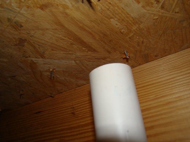

found the problem! vented right in the ceiling! What's the best remedy for this? BTW that's and 1 1/2" vent. Is it safe to say that is the vent for the shower and toilet also?

How to fix it will depend on the layout of the walls in the upper floor. You will need a vent line going from the basement upwards through the roof. If you have an existing vent pipe going through the roof, you may be able to tie into that in the attic instead of holing the roof again.
Dlarrivee
1,150
Canada
With any luck you can use a small drill bit to punch through the subfloor from above, where the wall meets the floor just under your base board, and mark out where the bottom plate of a wall above that room is...

Regarding the original concerns. The inside fitting flange on a 3" drain could cause a clog someday since the diameter of the drain is constricted too much. However, this would not cause a leak (Which you have determined was not the problem anyway) A single wax ring is all you want when the flange is on top of the finished floor, and you were correct in using the ring without the horn. In cases where 2 rings are needed on a recessed flange, the top ring can be the horned type as it helps keep the two rings aligned. Guess you know now why some folks refer to the vent pipe as a "stink pipe". Glad you found the problem.

The floor above that vent pipe is in a bedroom closet. Could I just run it over to come up right in the corner of the closet and straight up to the attic? This way I wouldn't have to tear drywall off and drill the bottom and top plate. Also is this 1.5" pipe big enough to properly vent this sink, shower, and toilet? I already have 3 vents going through my roof. I believe 1 is a 4" for the upstairs toilets and the other 2 vents are 2". Does it matter which vent I tie into?
You can go up in the corner of the closet if you wish, your choice.
Around here you'd need a 2" vent for a wet vented bathroom group though. You're looking at a lot of work to get there... I would tie into the nearest vent.
You need to connect that vent pipe to another one, or run it out the roof on its own. You may need to expand the pipe diameter when going through the roof, as in some places, it can cause frost to build up and close off a smaller pipe.
If you're lucky, you may have a 10-year HOW warranty, and they should fix it for free if the bathroom was there when you bought the place. That certainly doesn't meet code.
