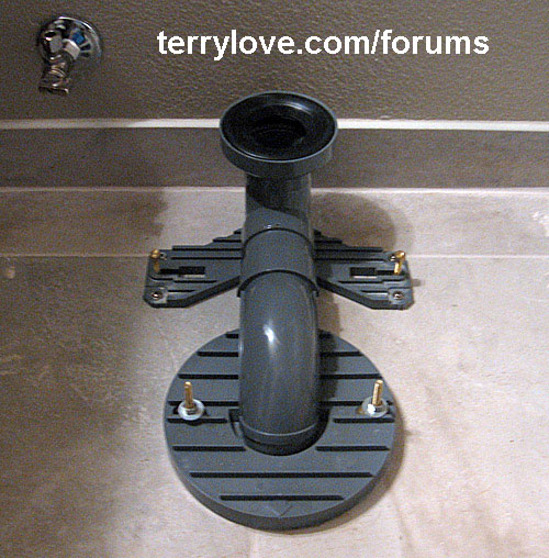

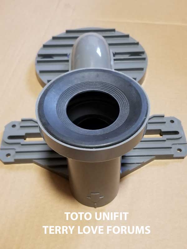

The Carlyle takes a Unifit adapter.
I don't know why your caulking was needing to be replaced in a few days unless something was leaking under the bowl.
The back of that bowl is open, can you take a mirror and give it a look?

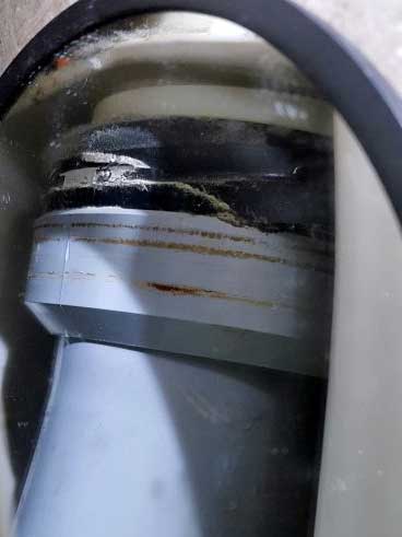

Nice call on the mirror picture thing!
That looks wrong to me. 12 inch Unifit adapters are often sold cheap, because when you buy a toilet, it comes with the 12 inch. https://www.ebay.com/itm/New-Toto-TSU01W-12R-Modular-UniFit-Rough-In-12/184113781538 Those who need a 10 or 14 inch adapter will be disposing of a 12.
I don't know if that existing black seal can just be restored, or if a new Unifit is needed.
IMO, the last guy to lift that toilet off either messed this up, or failed to see what somebody earlier had messed up.
I think that uses the Toto TSU01W or TSU01WR unifit, with a suffix-number of .10, .12, or .14. I would tend to think a lot of the Unifit toilets are sold for use with 10 or 14, since there are a lot of toilet choices that fit 12.

Does anybody think the plumber who pulled the toilet last did not mess up?
Can I ask, because I am not understanding from your last response (likely due to my layman understanding), are you seeing something in the photo that looks off in general or particular to the seal? The upper right looks a bit off in my eye but maybe it was my camera angle.

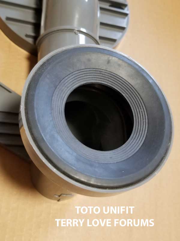

See Terry's picture in post #2? The toilet stuff that inserts is all white. Your picture shows black stuff, probably the rubber seal, where it shouldn't be. Can that seal be put back and be OK? Or should the Unifit be replaced? I don't know. I did not try to tug my seal out when I did mine.
I actually had both a 12 and a 14, and was going to modify things to fit my ~13.2 inch rough. I decided to modify the 12, because the 14 had resale value.

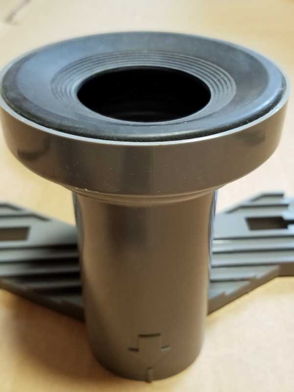

What a new Unifit looks like.
I have lot's of these on hand. I would pick up a new one for the reset of the bowl.
The picture you posted of yours looks to have a big gap where the spigot of the bowl drops into the rubber seal at the back, and I'm looking at a big gap in the rubber.
And looking at this picture, it doesn't really look like a standard Carlyle bowl setup.

Hey, Rob. The smell is not the water. But the water is a BIG clue.
The smell is sewer gas, which is putrid stuff that comes from the decomposition of organic waste, and in NYC typically flows up from our sewers throughout all the waste piping in a building. It is smelly because is it a brutal mix of things like ammonia, sufur dioxide and hydrogen sulfide.
You typically don't smell it because all plumbing fixtures are installed with some kind of water trap to block the gas at the trap. Under your sink, for example, that's why you have the U-shaped pipe bend. Water in there forms a seal against the sewer gas. Dump a bunch of water in the sink, it pushes out the water at the far end of the U, and the new water settles to maintain the seal. There's a similar u-shaped trap under your shower and tub, too.
With a toilet, the water trap is built into the fixture. So, when you install the toilet, you need a gas-tight seal between the fixture and the pipe. Usually, this is done with a wax ring or similar between the "horn" of the toilet and the flange on the floor. With a Unifit, you indeed use a wax ring to seal the Unifit to the flange, and the porcelain horn of the toilet "plugs in" to a rubbery gasket at the end of the Unifit closest to the wall, which is what you are looking at with your ingenious mirror photo and video.
The porcelain horn from the toilet is supposed to plug into a rubber gasket, as shown in Terry's photo. The gasket is supposed to be in the center of the Unifit. Your rubber gasket seems to have been pulled up and flopped over the top of the Unifit when they "unplugged" the toilet, and it looks like they just dropped the toilet back on the Unifit, but without any seal around the horn. And maybe cracked it, too. Hence your water leak when you flush.
That there is water leaking from the seal between the toilet and the Unifit means there is no seal (or a damaged seal). And if there is no seal against the water, there is no seal against the sewer gas. So you're smelling the sewer gas.
It comes and goes because the pressure in the drain lines and risers is going to come and go, and where the drain lines are vented, sometimes air will blow in and pressurize the drain lines and sometimes it will not. Sometimes there is air pressure into your apartment, sometimes there is air pressure out of your apartment. Where there is negative pressure in your apartment, it will draw air from under your door to the hallway, and -- unfortunately -- sewer gas from this failure to seal the toilet to the Unifit. If you have vents in like your kitchen and bathroom as many NY high-rises do (mine does), sometimes the rush of air is louder and sometimes less so. Same thing with your toilet.
