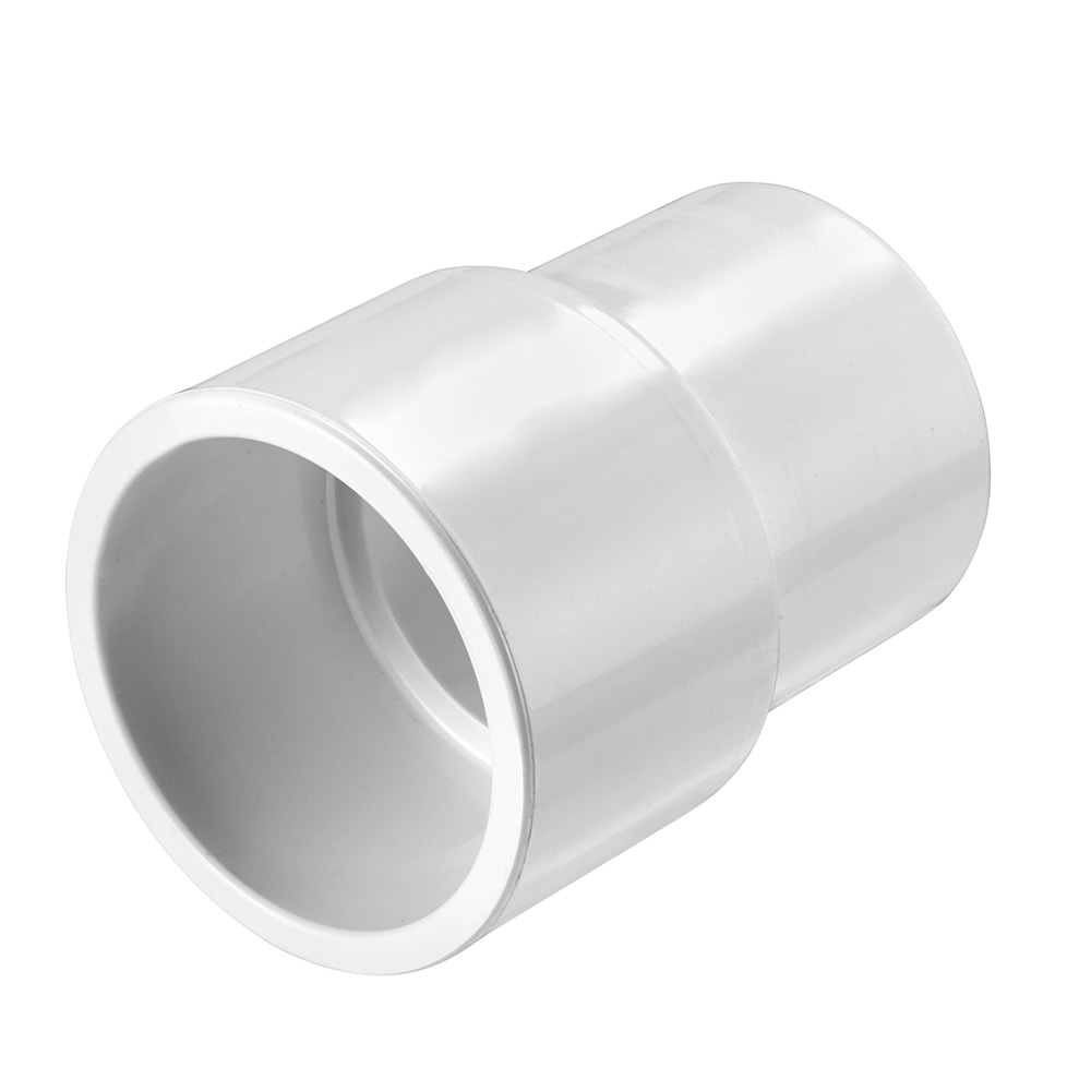

Do you know if they make a female adapter that goes into a 4" pipe rather than around it? In other words , the non-threaded end would have an OD equal to or smaller than the ID of the pipe?
42,093
5,180
This is exactly what you asked for if you have schedule 40, but does not elevate things:
These would give some elevation:
If schedule 40 https://www.pvcfittingsonline.com/c...ucts/4-schedule-40-pvc-pipe-extender-s0301-40 gives a top that is the same size as a 4 inch schedule 40 pipe. So you could glue a hub onto that.
Remember to measure your pipe before making plans.
