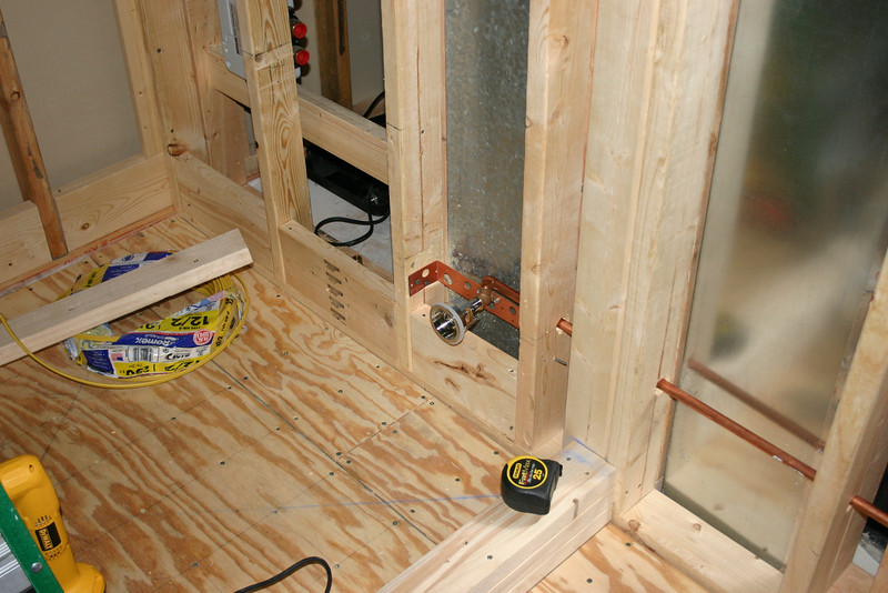

Installing steam generator outlet and don't have enough depth to to put normal blocking. What else can I use? Any pics/examples?

Are you talking about that 1/2" wide strapping sold by a roll or is there something more substantial? Do bix box stores carry it?

That material is too thin to hold anything. You need something like Sioux Chief 525-18 support bracket. The holes are small enough so you can use screws rather than bolts. You might also consider a "high ear" drop ear elbow which has the tab right above the pipe opening i.e., right behind the sheet rock, so conventional blocking could be used.

Found this at Lowes, feels pretty secure.
