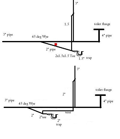

    well., maybe this is a better question., itll be a bit hard to explain
    does a vent have to be after the p-trap?
    can i have (from right to left)., vent., 90 deg elbow., tee or wye., conncted to p-trap., then continues ....
    here is a sketch of whats been done., there are approx 5"-9" between the borrom of the floor joist and the ceiling (below)
    [​IMG]

    i see what you are saying about an s trap being created., but... it isnt as S... for ex., in the attached image., it goes straight down..
    in mine., the P trap is connected to a 1/8 bend down., then a straight., then a 1/8 to correct the prior down and tilt it towards the waste... which then connects to the tee....
    do i need to post better pics?

    That is why I called it a 3/4 "S" trap because it goes at a 45 instead of down, but it is still an "S" trap, and it is still illegal and a bad idea even if it were not. Your top drawing is the correct and best way, BUT the trap has to go directly to the vent without turning down. Once it passes the vent you can turn it anyway you want to.

    hmm., in order to remove both the 3/4 s trap and the flat vent., what i could do., is., have the ptrap go from left to right (away from the waste wye), towards the vent, have it connect to the vent with a wye, then use a 180 deg elbow? ( is its called a U?.,) .. so that i can go back towards the wye that you see in the picture.,.,
    would a p-trap., into a straight + wye (vent) + straight + 180 deg elbow (turning around AND down) + straight., into wye in pic ? work?!>

    I'm not a plumbing pro, but you'd probably want to avoid using 180 degree turns. You're making it too difficult for the waste to flow properly.
    It may almost seem that reframing may need to be done, or notching and then reinforcing.

    How about a 90 1 ft straight and then another 90... Giving the 180 a lil stretch

    i have been wondering why i created the 3/4 s trap in the first place.....
    i was up there and noticed the old 1.5" p-trap that had been removed... turns out., that one was als a 3/4 s-trap., which is probably what i was replicating.,

    Your idea of a "U" bend is bad, but we would have to be there so we could see the entire situation to determine the best option. Your pictures do not give us enough information about the area to make a decision.
