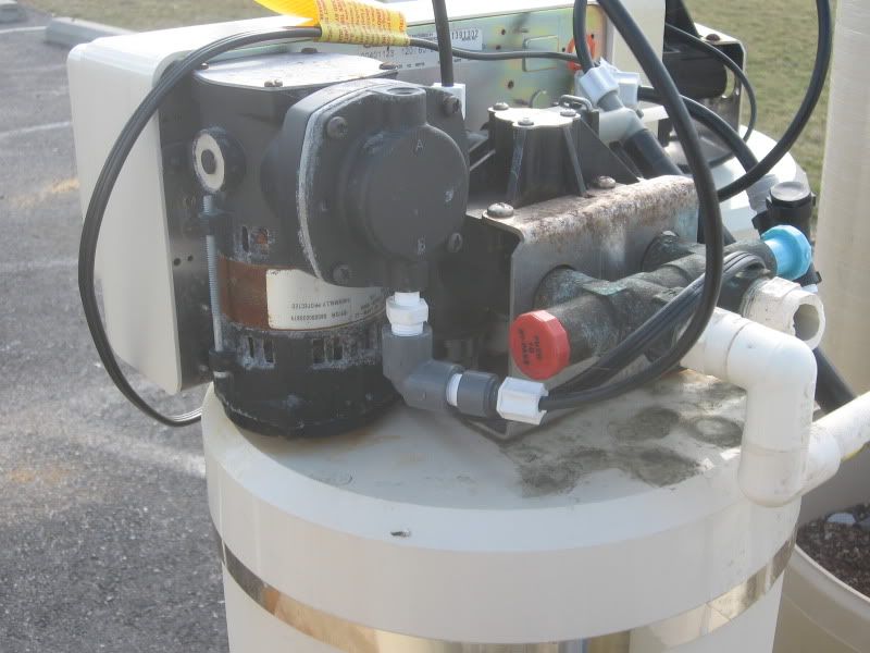

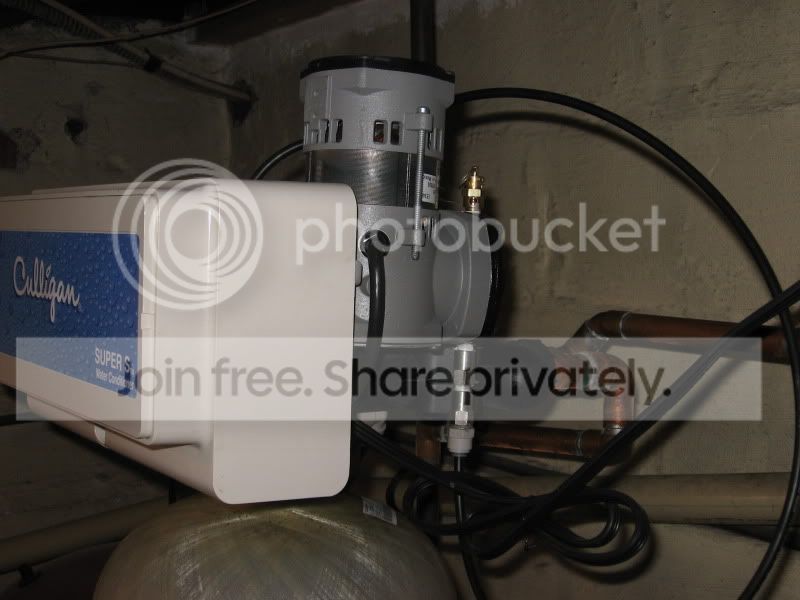

Here is Culligan's Super S system with pump.
It sounds like your's is a homemade job. Saturating the carbon with large volumes of strong bleach often enough with shorten the life of the carbon fairly quickly.

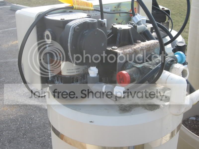

They really like that little pump on their systems, it is on this one and there is the iron buster that they use the that same pump... One has to make sure that no water gets to the pump or it is out of the game, and spendy to rebuild.

Like this that 'frooze up' due to moisture. Culligan said it wasn't repairable at the cost of replacing it.

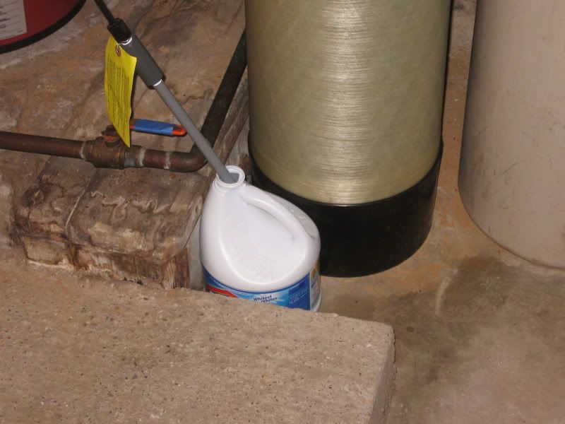

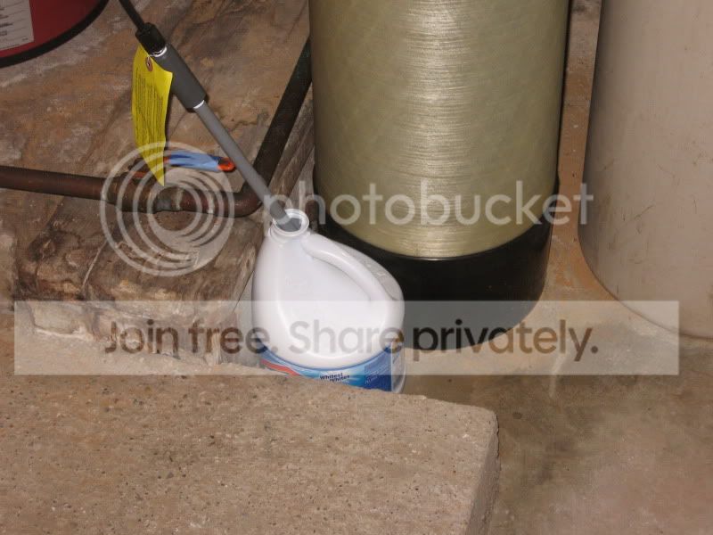

... here's info on that part of the system: the filter is upstream from my softener. It's a 3 cu ft resin tank with a Fleck controller on top and a water-filled tank attached to that Fleck. The setup looks just a water softener, with carbon in the resin tank and water from the brine tank that's used for backwash cycles instead of regen cycles. I was told to add a bottle of bleach to water tank weekly to shock that filter (which is what I meant by sanitizing earlier).
The filter is regenerated with the chlorinated water out of the brine tank during the slow rinse/brine draw cycle position; the same as a softener.
I have never heard of using carbon that way but, Pyrolox had been used like that for many years except the gallon of bleach was added every 3-4 weeks depending on how much iron, manganese and/or H2S was in the water and how much water was used. I sold many of them back in the '80s into the early '90s.
I can't imagine the average residential well pump successfully backwashing 3.0 cuft of Pyrolox. Pyrolox is very heavy an difficult to successfully backwash. Are you absolutely positively without any doubt that you have carbon in the filter? Pyrolox is black like carbon.
How sure are you that you were to add the gallon of bleach each week? That is way too much chlorine and way too frequently for any type of carbon. My Pyrolox filters only sucked 3-4" of chlorinated water off the top of the water in the salt tank and the tank had water in it up to about 11-13" from the top. So compared to once a week, the solution strength was much weaker.

Based purely on the word of the designer/installer, there's carbon in there. And oops, I looked at my notes and I was originally toldto add 1 gallon bleach per month, not week. I don't think I've exceeded that rate. If anything, I did it less than once per month. The weekly instruction came recently, only for me to do for about a month. Attached picture shows this side of the system. Blue tank in back is pressure tank. That feeds into carbon filter in foreground with Fleck controller - cover. That filter is 12" diameter x 50" high. The white tube snaking around that goes to the black water tank. Culligan system is in back right of the picture. I'll also attach a picture of inside water tank. Yellow gunk on bottom is powder, I stirred it up and it re-sedimented after an hour or so.
Not following the schedule will ruin the filter's media. With carbon, more chlorine by adding it more frequently will also. So now the media needs replacing again.
