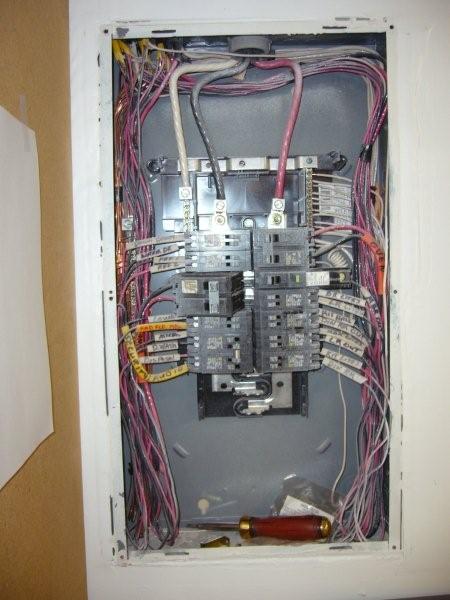

    I have two "main" panels for the house, both of about the same size. One on the outside, then one on the inside (that's fed from the one on the outside).
    outside
    [​IMG]
    inside
    [​IMG]

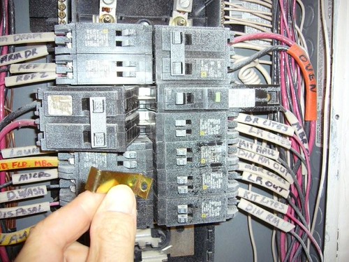

    On the inside one, there's a feed - dual breaker - going to a smaller breaker box that's dedicated to my power tools (so I could lock it out if I wanted to).
    dual breaker, pulled off, showing the retainer the electrical place sold me. [​IMG]
    The inspector says I need some kind of retainer holding this dual breaker down, so that when you flip it off, it won't pull out of the panel (funny thing though - he didn't mention the same requirement for the ones for the oven just adjacent to it).
    My outside panel has one of these retainers- for the MAIN power breaker(s) - 200A.

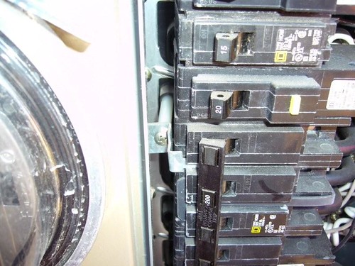

    Here's the one on the main panel outside. There's screws
    [​IMG]
    BUT, on my inside panel, there's nothing "behind" the breaker that will allow me to fasten it down.
    Any suggestions on this? The "box number" of my inside panel is BXH26/K if that helps. Square D's website is where I found that gold colored bracket (that doesn't fit), and otherwise was no help.

    The inspector is quoting 408.16(F) Back-Fed Devices.
    Plug in type overcurrent protection devices or plug-in type-main lug assemblies that are backfed and used to terminate field-installed ungrounded supply conductors shall be secured in place by an additional fastener that requires other than a pull to release the device from the mounting means on the panel.
    so basically what this means is that if you are backfeeding a breaker to supply a panel you need a means of holding that breaker in place.... THis would only take place if you bought a main lug panel and wanted a MAIN disconnect...

    Also, DO NOT (!!!!) attempt to install this device. Like you said, there is NO place to screw it to. If you try you'll quickly find the live buss bars.
    The outside panel is a "one sided" panel if you notice. This is why there is a place it install a back-feed breaker hold down.

    This breaker DOES NOT need to be retained. This is NOT a "backfeed" breaker.
    If the AHJ says it does he is most certainly incorrect.

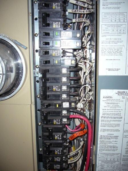

    [​IMG] Does this help? Is that subpanel backfed or main lug?
    Jason

    That is a Main Lug panel. I can see the ends of the feed conductors poking out through the main lugs at the top of the picture.
    The breaker that is half-out near your fingers is the one that is feeding another subpanel or other load. It is NOT a backfed breaker and doesn't need to be fastened in place.

    That is NOT four breakers. It's two 2-pole 100A breakers mounted in parallel creating a 2-pole 200A main breaker.
    Very common thing to see in some panels. Siemens did this for years. Still does I believe.
