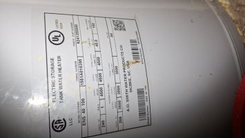

Replacing a 3500 water heater element with 4500
RuthBerry
11
Texarkana
Hey folks. I thought both of my elements were the same so I ordered two 4500. Then my wife noticed that the panel shows 3500 for the bottom. I have a 20 amp breaker. So am I screwed? Do I need to buy a 3500 watt for the bottom or will the 4500 work? The panel is a little confusing
GReynolds929
806
286
63
WA
The 3500w on the rating plate is for if you were using 208v for power. Using 240v which is most common in residential settings the elements are 4500w.
