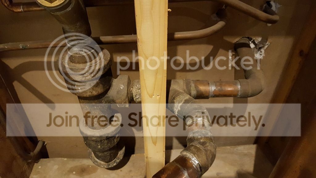

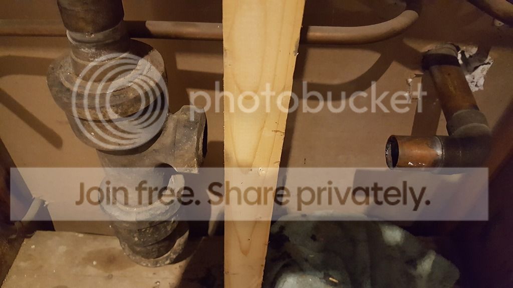

I have removed a wet bar, what remained I quickly capped during demo, to figure out later, and now it's later. I want to remove the Y from the cast iron(?) drain that is heading to the sink drain, and replace it with a straight section of something into a 90 degree back to the existing sink drain (on the right side of the photo:
hopefully my pictures work for everyone, it's my first post so I'm assuming the photo img links work?
Anyways I'm mostly wondering before I embark on this can I just bang/heat the threaded joint and put a wrench on it to unthread the joint? any worries of breaking things? brittle cast? brittle galvanized? things like this? I'd like to diy this unless you guys think this is a terrible idea. thanks

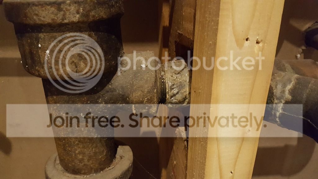

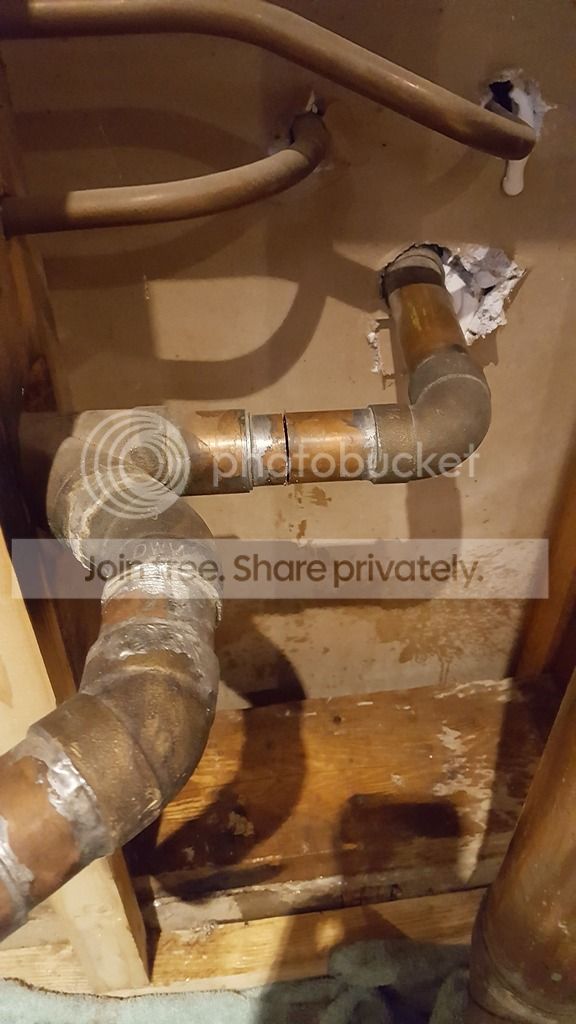

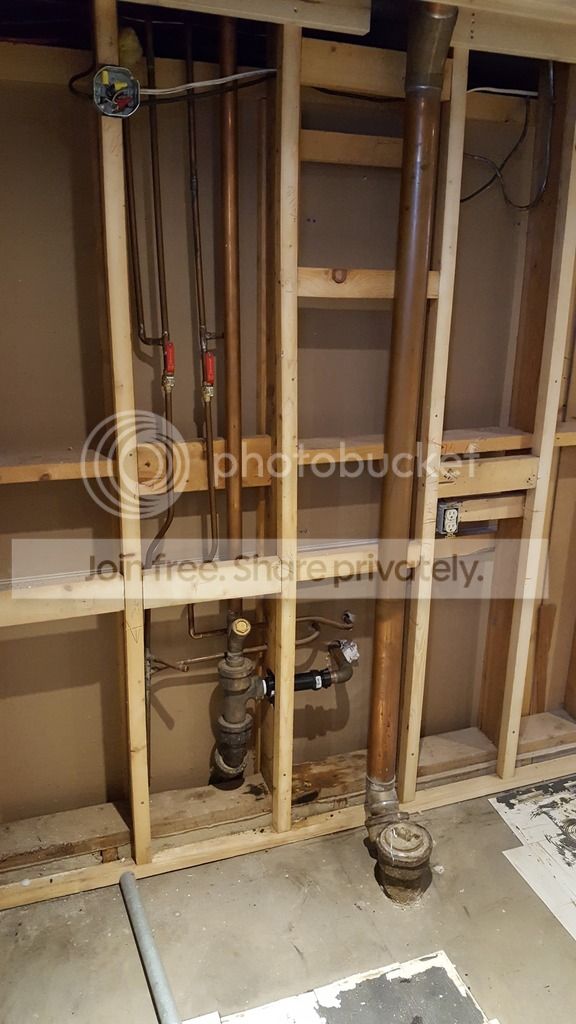

I have more work to do to tidy up the area but but main job is that cast iron and threaded Y removal, so that's my first job and worry
That nipple should unthread from the fitting. Sometimes a little heat on the hub of the fitting and a large wrench.
The large pipe wrench may be all that's needed. By this time, the nipple may need replacing anyway.
If you were removing more fittings, like the cast into the cast hubs, with those I may take a drill and flat blade screwdriver and drill out and pry out the lead there. They make a rubber sleeve that lets you insert a 2" pipe in it's place. The sleeve goes in the hub, and then I taper the end of the pipe, add a little liquid soap and push it in.
Banjopete
Edmonton, Alberta
Thanks Terry for the reply, at this point I don't need to expand the scope of the project so it's just removing the threaded Y (fitting?) from the cast column. Just so I'm clear the nipple you are referring to is what I'm calling the whole Y piece? or is it just a male/male threaded connector ahead of the Y fitting (sorry I don't know the correct lingo)?
Banjopete
Edmonton, Alberta
I think I answered my own question regarding the nipple. To confirm, from the main drain stack, there is a male/male nipple, threaded into a female y fitting and onwards to my sink drain. So I could try to unthread the whole nipple and fitting and see what gives first, then replace the nipple into the cast main drain stack, and replace my Y fitting with a straight piece of appropriate pipe and make the connection on the other end with rubber/pvc fittings of some kind from the local plumbing supply? Am I crazy or on the right path?

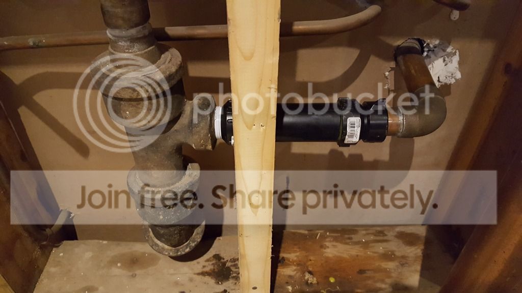

Well great success thanks to your help Terry, I got a wrench on the pipe after cutting it off and it came out without a fuss. The ABS was great to work with and I knocked out two plumbing projects pretty quickly. This fix I was asking about put all my plumbing (save the main toilet drain) back into the wall so everything seems a little better now.
