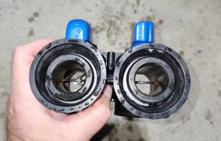

See the picture for where it broke. Not the first time ive had a piston break in this area.

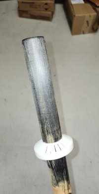

I removed that basket and bought an umbrella type diffuser for top of riser tube.

I've been cleaning the valve and bypass, started by soaking it in a solution of water and iron out. And today, diluted some bleach in a bucket of water and cleaned them up some more. Rinsed them good in clean water afterwards.

turns out my riser tube is 32mm (~1.25" diameter) and the umbrella diffuser is for 1.05" risers (it's ID was under an inch). I just took the dremel to it and went to town til it fit over the riser tube. fits very snug now and got it down about 6" down the riser.
