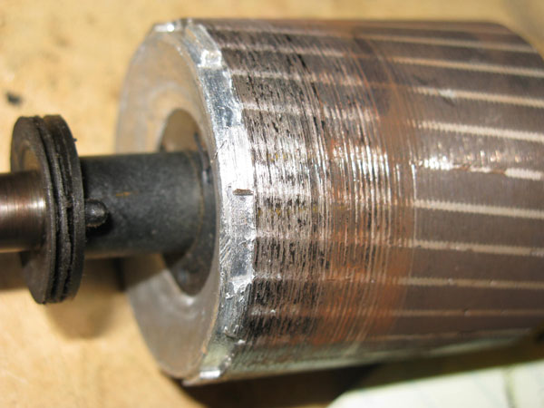

    Not pump related, but I recently pulled apart and lubricated the motor on my HRV which has been running continuously for 13 years. Cheapo motor was purported to have lifetime sealed bearings. PFFT! The "seals" deteriorated and the lifetime lube was a bit of oil in a felt wick while the bearing was nothing more than a bushing. Aparently I did good to get 13 years out of it.
    http://www.nlcpr.com/VenmarMotorReplacement.php

    Thats a great motor at 13 years. Sintered bronze bushings with a wick [nice to refill it every 5 years] are bomb proof and likely better than the singapore BB.
    But I gotta guess that the other end had ball bearings or a thrust bearing, because no bronze bush motors run vertically for long. Unless its hoover dam or your car engine and the oil is pumped in under pressure - then they can go FOREVER.
    drilled a lot of holes into the bushing area of motors to get a drop of oil in.

    No, both ends had bushings. Layered plastic and felt washers for thrust on both ends.
