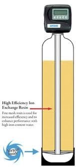

Everything eventually fails for one reason or another..... Sch40 pvc pipe is supposed to be good when
installed out of UV light for about 900+ years .
Look at flint Michigan when some DEI hire decided to get water from another source and
it was corrosive to the system leaching tons of lead into the city water and then all hell broke loose
and somehow the governor got blamed for the whole mess...
Disgruntled People leave positions in local government and many dont look back and leave their jobs with the
hope that other new hires will screw everything up
others have to pick up the slack as best they know how to... for better or worse...
Someone somewhere will add too much chlorine or chlormines into the water system for a whole community
and then all the pex pipe will probably start falling apart over a period of a few years....
we have this issue right now in our town with water softeners that explode due to too much chlorine in the
water system...... and the beads expand and rush out the top into the plumbing system .....
