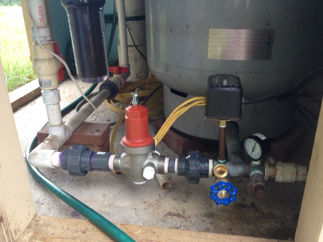

Hi,
I just put an order in for a cycle stop valve but I want to double check my installation to make sure I'm doing it right.
Question 1: Is my pressure switch and valve settings appropriate for my house to get good consistent pressure throughout?
PK1A-LT Pside-Kick Pressure Tank Kit
Pressure Switch: 50/70 PSI
Valve Setting: 60 PSI
Well Pump Type: Submersed, ~100ft from house. 1/2hp
Pressure Tank: Amtrol WX-251, 62 gallon set to 47PSI
Well Entrance: ~5 feet below ground level, basement entrance.
Stories: 2 @ 9ft ceilings
Loss factors:
- Farthest bathroom from well entrance is approximately ~100ft horizontal, ~20ft vertical
- 3x Big Blue sediment pre-filters, 1 nitrate removal tank, 1 softener tank (rated 75PSI max)
- 3/4" copper trunks with 1/2" branches
Question 2: I've seen several installations. The manufacture shows the kits with the pressure tank attached via the bottom, but several posts have it attached after the fact. Do they function the same way? Are there any differences between installing a 3/4" pipe down to the floor and into the Amtrol vs bringing the CSV down to the floor and installing the Amtrak in line to the 1" NPT outlet?

No problem attaching the tank to the 3/4 port on the bottom or downstream of the CSV1A as shown in the last picture. Either will work. And yes the PK1A will deliver strong constant pressure to your house. However, a WX251 holds about 15 gallons of water. You will have to use all 15 gallons from the large tank as the pressure drops from 70 down to 50 before the pump starts and you start seeing the 65 PSI constant pressure than the CSV1A needs to be adjusted to hold. With a 3 GPM shower going you will see the pressure drop for 5 minutes before the tank is empty and the pressure comes up to constant 65 PI. With a small tank you wouldn't have to wait 5 minutes for constant pressure. Other than that the large tank is fine with the CSV1A.

Thank you. I understand the larger drop, it's something we're willing to deal with since we get frequent power outages. The extra gallon or two that we get after an outage is usually just enough to get us wrapped up and one or two emergency toilet flushes.
We are bumping up there pressure switch - previous 40/60. It was good pressure at 60 but terrible (for us) and good enough at 40 before the pump cycles on for the lower bathroom but horrendous for the furthest bathroom. So this is hoping that an extra 10psi for a drop down to 50 won't be too noticeable before holding the constant 60.

Just to make sure..
Since the WX251 isn't designed to go upside down and be suspended I was planning on using the 3/4 port on the bottom of the CSV and running 3/4 pex down (~3 ft) to my pressure tank. I was going to leave everything else as is in the first picture with the PRV, gauge, and switch up near the CSV. But then I saw this in the instructions. "Do not install pressure switch directly on main line away from pressure tank" so figured I would double check.
I wasn't sure if that meant the pressure switch further down stream on the main line, or if what I was attempting to do would mess it up as well since I was going some distance downwards. I would think it would still be ok but trying to be safe than sorry.
