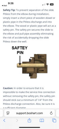

Here’s what we learned: When changing both sides of a pit less, use a small piece of pipe that slides in between both halfs to hold it together. It is then impossible for the half not attached to the pull pipe to fall down the well.
I am trying to picture that. Is the small piece of pipe horizontal?
Yes—in these instructions, they are using a wood dowel, but a plastic pipe works just as well. We demonstrated it to the judge, how it was impossible for the outside half to slip off no matter how loose the two halfs were.
The inside part needs to be installed with the pull pipe. Don't think you can install it while attached to the outside part of the pitless.
I can see where the Dowel rod would be a safety. But the pitless slide fits really tight. I have never needed the Dowel rod to install a pitless.
This was a repair of a leaking pitless. So it wasn’t new. Obviously wasn’t tight or it wouldn’t have slipped off. Maybe the contractor hit it against the side of the casing as he was pulling the whole thing up.
Are you a contractor? Play it safe and use a slide!
I would have pulled the pump first before working on the pitless. That way if the slide did fall it would be laying on the bottom of the well where is wouldn't hurt anything.
