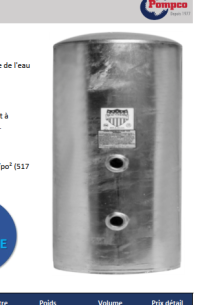

At my cottage, I currently have a jet pump and diaphragm pressure tank. It works well except:
1. In the spring when I hook it up. Takes forever to prime and fill intake pipe. And until all the air is pumped out, the pump deadheads until I can purge the line.
2. Air in the line is an occasional problem throughout the season as well.
3. If there is a power outage (happens regularly enough) and someone uses water, pressure will drop and it will lose prime.
Now this is not a big problem right now because I'm usually around to fix any issues that come up. But my wife and kids would have no idea what to do. Ditto for my sister and BIL who have the cottage next to mine and get their water from my pump.
My cousin, who has a cottage next to ours, still uses a 50+ year old piston pump. I set it up in the spring. It self primes and doesn't cause any problems. Ever.
So thinking about the future, I'd like to make my pump as foolproof as possible, I'm thinking of replacing the jet pump with a piston pump.
Now for my question.
I contacted the pump manufacturer to ask about the maximum pressure a particular pump could build (FWIW, it's this one: https://pompco.com/en/products/piston-pumps/regular-model/). They promptly answered but also provided additional information for which I needed clarification.
He essentially said that captive air tanks are not recommended for a piston pump and I should instead use an hydro-pneumatic tank. Not knowing the difference, I googled it and found even more confusing information on what an hydro-pneumatic tank was. Google essentially said that my diaphragm tank (as well as bladder tanks) are hydro-pneumatic tanks. I again asked the vendor for some clarification and he said that you don't want to use a pressure tank that pushes against the pump. Instead, you only want the pump to provide the pressure. He gave me a link to a recommended tank and it is essentially just a reservoir as shown in the picture. He said to keep my pressure tank as it will work and not damage the pump. But he added that when the tank fails, I should consider the hydro-pneumatic tank even though they are generally more expensive.
So exactly what it an hydro-pneumatic tank. How does it work to provide pressure? I'm assuming any air in the tank gets compressed. Is this the same as an air-over-water tank? Are these trouble-free? Anything else I'm missing? Thanks

Hi Chucky. Piston pumps will draw a prime much easier than a Jet pump, but not as easy as a submersible. They have there problems but most can be mitigated.
Hydro Pneumatic just means air over water tank. Bladder and diaphragm tanks qualify as Hydro Pneumatic as well. The difference is captive air or not captive air. Bladder and diaphragm are captive air, meaning the air charge is installed at the factory and can't get out. Most people call diaphragm and bladderless tanks Hydro Pneumatic, because that's all they got. Lol.
All pumps will prime easier into a Hydro tank compared to a captive air tank because Hydro tanks start at zero pressure. Captive air tanks start at the air pre-charge amount. 30/50 switch, 28 PSI pre-charge, pump starts at 28 PSI instead of zero and primes easier.
The downside is you have to keep adding air to a Hydro tank as automatic air volume controls are not reliable. They get waterlogged often. Captive air tanks never water log and don't need regular air charges until the bladder or diaphragm fails. Failing bladders and diaphragms are a common problem for those who don't know how to eliminate cycling, which is what destroys bladders and diaphragms and makes some people think hydro tank are better.
To me, that suggests that he is saying that that particular piston pump adds air on a routine basis. That is an advantage to a hydropneumatic tank, and then the tank would have an AVC valve to release excess air.
You may sometimes see hydropneumatic tanks called "conventional" because they were the norm once upon a time.
An AVC on a jet or piston pump adds air to the tank. An AVC for a submersible releases excess air from the tank. Neither are very dependable, which is why the captive air tanks are much more popular than the "conventional" or "hydro" tanks.

So would the piston pump work well with the AVC port plugged, and using a precharged tank?
That would make sense. He did add that if I used a captive air tank, I might see air coming out of the faucets every once in a while. I'll confirm this with the manufacturer
A properly installed jet pump/diaphragm pressure tank/foot valve combination should never experience any of your issues.
Well, I agree. But this is a seasonal cottage so the pump gets disconnected every fall. I usually have those problems when I re-connect the pump and until all the air is purged. Just a tiny amount of air causes the pump to deadhead. It gets close to cutoff but not quite. It's only when I open a valve to let the air out that it stops. Like I said, not a big problem but the spring-time setup is too finicky for the kids to manage.

Lowering the pre-charge will not work the same as a hydro tank during priming. A hydro tank at zero pressure will accept some water as the pressure increases. The diaphragm in a captive air tank is shoved against the inlet/outlet hole, and the tank cannot accept any water until the pressure increases above the pre-charge amount. If a pump cannot push water, it cannot draw water. With a captive air tank a tap needs to be open during priming for there to be a place for water to push. With a hydro tank the pump will usually prime without a tap open.
The lever on the pressure switch (low pressure cut off) is a good idea on jet or piston pumps. You don't want these type pumps to try and re-prime when you are not there. It is a pain to have to go lift the lever, but at least the pump is not melted.
The Cycle Sensor can be set to manual reset and would work well. If there are already 3 wires to the 115V pump, moving the common to a second (double) breaker would make it 230V.
Air Volume Controls are ok if you need them. But if there is anyway to eliminate an AVC, like using a captive air tank, it eliminates several more possibilities for failures. It has been my experience that the extra check valve, tubes, schrader, and other parts needed for an AVC just make a water system less reliable. Tearing a bladder or diaphragm is the biggest drawback of a captive air tank, and when used with a Cycle Stop Valve to eliminate the cycling torn diaphragms are no longer a problem.
