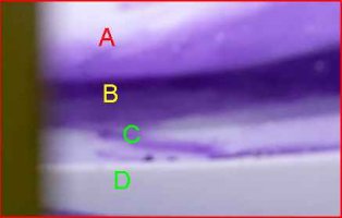

I'm working on gluing up the drain for the toilet. After I measured everything out and glued it together, I discovered that the length ran about 1/4" longer than measured.
I sent my phone into the pipe to have a look at the inside to see what happened. It looks like the pipe is not fully seated (see pic and video); it's 3" pvc and 1.5" should have gone into the hub of the fitting. I cut all the pipe with my miter saw and knock the sharp edges down on both the inside and outside with a box cutter knife.

At this point, I stopped and wanted to get some opinions before I go any further. Is this going to be a problem? It's not terribly difficult to cut out the 3x2 wye and redo; albeit 1.5" closer to the stack.

Is the suspect socketted fitting the wye on the right side of the first photo? Could you cut it out, lose 1.5" of pipe and make the next 1.5" longer?
Likely it wouldn't ever be a problem if you didn't know it was there, but now that you do know and you leave it, that would cause problems.

So is the gap 1/4", and the 3" joint take up is 1-1/4" instead of 1-1/2"? Would that ever really be a problem? I'm having trouble seeing it.

How does this picture relate to the first picture?
What is part BC? Is that part of part D?
I agree that glued in 1/4 inch short should not cause a problem.

The pipe and fitting that is in question is the wye and the pipe to the right of it.
The pipe into the 45 fit perfectly; I had better leverage to push it in.
Would this ever be a problem... either with leaks, or snagging something from the WC, etc? That's what I'm trying to wrap my head around.
I would hate to have this become a problem in the future.
In the picture the pipe is on the bottom (D); the pipe on the far right of the overall pic.
the unintended gap is C,
the fitting stop is B
The fitting is A.
Honestly, if I didn't size the pipe to end perfectly at the fitting under the WC (not in pic), I would never have known but my measurements were off and that caused me to investigate.

So is C only 1/4" wide, out of the 1-1/2" hub depth? If so, I suggest ignoring it.

Not being fully socketed that 1/4" is not going to cause a leak or loss of strenght. It likely will fill up with gunk and be a very slight speed bump in the system.
