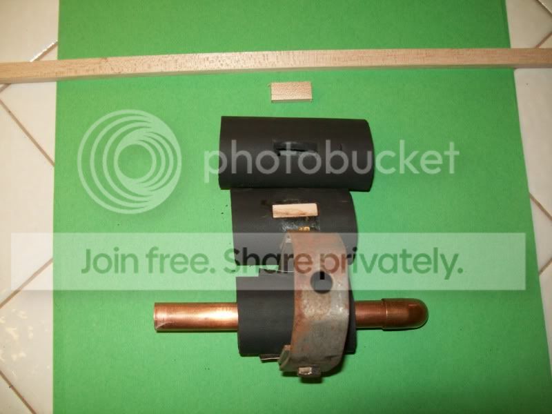

    9. Narrow pieces of wood , they could be 1" inch long and 1/2" square. A hardwood is best. You will need these where pipe is hung with pipe strap, ETC.
    10. Some good duct tape. You will need this for covering the piece of wood where you have cut a small rectangle and glued in the piece of wood to support the weight of the pipe with water in it so it does not flatten the insulation on the underside of the pipe.

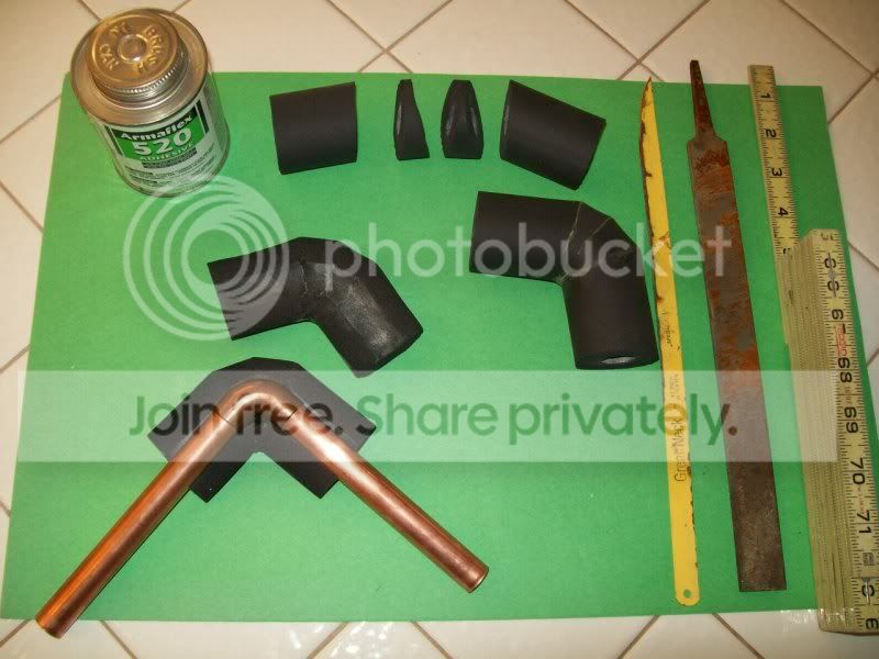

    pushing the insulation around fittings is a huge NO NO!! You are causing it to be pinched on the inner part of the elbow and cause stress and stretching on the back side as well. You will also damage the inner skin of the tube. You do make a point I forgot to mention. As you are installing your piping system you can cut lengths that are shorter than the pipe to save time and glue, just slide it over the ends of your pipe being careful not to tear the inside skin. Once the installation is complete you can do a leak check and then finish the insulation work. I make elbows out of four pieces. It's about a 30 or 33 degree angle. I have been doing it that way so long they just pretty much come out in a perfect 90 degree. Even if you don't get them perfect you can still have room to fudge it and they will still look good too. You will need the glue in order to cut the miters. You could use household contact cement but the 520 is a better product. Armaflex may still sell tubes that you slide the insulation through and then cut the miter joints. They make the 90's out of two pieces, I think they look ugly with that big squared end sticking out. You also have to cut more accurately too. Armaflex can be purchased in several large diameters and wall thicknesses. They also make it in a 3' by 4' sheet in several thicknesses. They also used to offer a package of templates to lay on the sheet to cut out for big piping jobs. I used to have a set that I had transferred to 1/4" plywood with the size written on them and a nice wood finish too. I had left them in my barn in Indiana and the guy I rented the house to when we moved to AZ burned down the barn! The problem with insulation foam tubing is there is no directions on how to properly install it. Most people take it home and force it around the pipe and slob it up with duct tape. I have seen contractors come on campus and do the same thing. It's just ugly and disgraceful!
    In Indiana there are M E N A R D S stores that actually carry a premade elbow and tee, ETC fittings. You may want to check that out. They may be the harder foam stuff that I am not a real fan of. It may just be a silly preference thing. I do prefer the Armacell. There is another company that makes a similar product but is slightly more dense and stinks bad. The name escapes me though. This type of insulation is a great product but at the same time it is very delicate to install properly. Pipe insulation is an art form in of itself. Union insulaters sometimes make more than a union plumber or steamfitter. You really have to know a lot of math when doing big insulation work. Pretty much the same as a sheet metal guy. The other brand is RUBATEX.

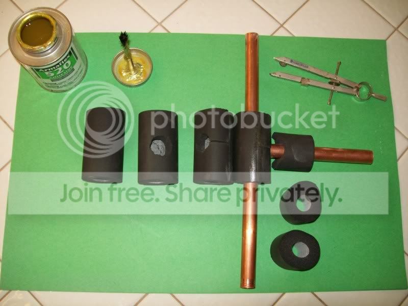

    Taking measurements might seem unimportant. Measurements are taken from END to CENTER, CENTER to CENTER and END to END. This refers to the bottom pic.
    [​IMG]
    The pictures seem to be getting jumbled. Here is a photo of pieces that I cut, one that I have glued together and one that has been cut into two pieces to show consistency of wall thickness around the entire 1/2 " copper elbow. You won't get this when the insulation is forced around a elbow or when the pre slit stuff is forced around the diameter of the pipe. KNIT PICKER NOTE: OK, so they are not perfect 90's. I have not made any of these for awhile, I'm a little out of tune. It's nice that this product can have some room to cheat.
    There is the hacksaw blade that I grind down on it's back edge to a point. A file can be used to keep the edge roughed up. It is crude but they are cheap and expendable. If you lose it in your attic or wherever you can barely fit in while working on the insulation it will be easy to replace.
    I'm not even going to try to convince anybody this is a fun job. When I worked at Purdue, I volunteered to be the insulator. There are plenty of times that holes were not big enough to accommodate the insulation or pipes were too close together because of space or worse yet, trying to put insulation around a pipe with one hand while trying to steady myself in an awkward position. Normally the plumber was responsible for doing their own insulation work. The insulator job was born out of politics and when the old boss retired, that job did too. It only lasted about three years. Then I was back out doing plumbing and the insulation too like everybody else.
    I'm really interested in guiding you through a job that you know will get done to the best of your ability. You can have the most beautiful pipe installation in the world but when you do a sloppy job with the insulation, this is what everybody sees and you pretty much have to judge the job by the cover. If you paint it to color code it, it will make what looks bad bare even worse!
    The other nice thing about a elbow like this is it can be cut open from the front, back or either side in order to put it on the pipe. You won't always get a good 360 degree view of the work. Be sure the pipe is wiped clean of flux residue and moisture before putting it on. Also be aware of solder drips hanging off of fittings that might be unseen, they might cut you.
    While I'm thinking about, I would like to say that a ball valve has got to be the hardest thing to put insulation on and still look decent. I have seen jobs where a ball valve extension handle is put on to raise the handle. They are expensive but do help quite a bit. They are hard to find too.
    If you have a water line with a heat tape taped on, naturally you will want a larger size insulation. This product is not fond of being stretched.

    Tees are pretty simple. Measure your center line to your end or use a random length. You can take your fancy circle maker and scratch an outline in the skin as a guide for you to cut at. This will be important if you are doing large pipe jobs. You can also just free hand a hole. That is what I did here. If they look ugly or are a little big , it is of no matter. I free handed this fish mouth cut, I have made nicer and I have made worse. Again, this type of insulation can be forgiving and can be fudged a good bit. Big box stores sell a gray colored insulation that is much firmer than the Armacell and greater care will need to be used. You are simply contour fitting the cut pieces together like a puzzle. Could be a great activity for a little kid.. Just for fun you could figure a scale to make sure the letters are the same size and cut all the angles to spell your name.
    I cut the circle first. Then I cut it through it's length. Then I cut it from the edge of the circle to the length cut. I do not ever cut it through the center of the circle at it's length. It's hard to explain, but it takes strength away from the insulation. They are really hard to glue and need a lot of baby sitting. The first part I glue together is the area from the edge of the hole to the length cut. Then I glue the length. I will glue the fish mouth part at it's length then the fish mouth part to the other part.. I'm sure a video would be more helpful here.

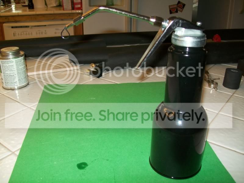

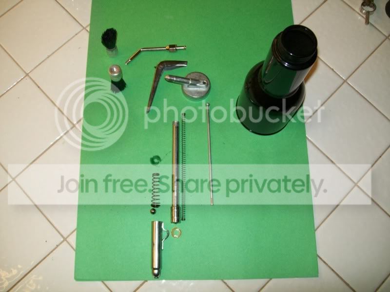

    http://www.mcmaster.com/#adhesive-dispensers/=8knhh3
    [​IMG]
    [​IMG]
    [​IMG]
    Here are some pics and a link about the handy dandy glue gun I mentioned earlier. You will need to get a small plastic dedicated container with a good sealing lid to put a used brush in. Spray enough WD-40 in the container to cover the brush or brushes in when they are not being used. The brush will last a long time when properly cared for. When you are ready to use a brush you will remove it from the container of WD-40 and laying the brush flat on a sturdy surface you will drag the tip of the knife through the bristles to pull out the old glue. When most of the glue is removed you can put the brush back on the glue gun and pump some fresh glue through into a rag. Take the rag squeezing and pulling the bristles to remove excess WD-40 and then you are ready to use the gun again. If the gun has set for awhile, just pump some glue through and use a rag to work the glue into the bristles to loosen them up again. The gun is pretty easy to take apart and clean. The brushes are of very good quality. You can bend a wire to put through the hole of the used brush to help retrieve it from the container with the WD-40 in it. If you are in the handyman business this will be a real time and glue saving tool.

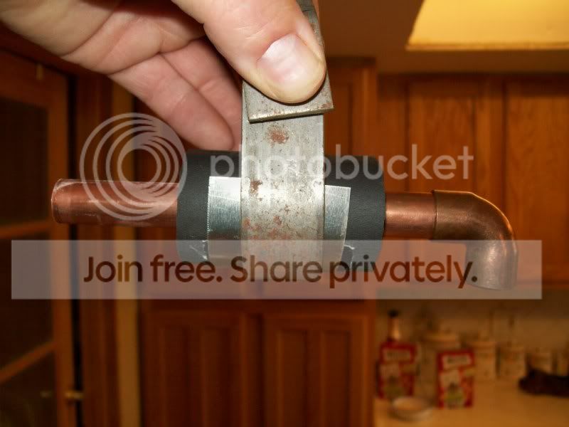

    Supporting the pipe insulation in hangers or resting on any surface is important to maintain it's shape and integrity. The weight of the pipe and fluid within will cause it to become flat on the bottom. I found this nice piece of maple wood perfect for this lesson. I cut them into 1" long pieces. You can gently press the block to the skin of the insulation and it will make an outline that you can then cut out the rectangle. Next glue the piece of wood in the hole. Put a little bit of duct tape over the block because I said too. Then place it on a piece of bent metal to help protect the skin. The hanger is a clevis hanger, not typical for the home. Whatever hanger you have, make certain you are not squeezing the insulation down to hang it. If you are using unistrut and the clamps, insulate the inside of the channel as best you can and then cover over the clamp . I have seen insulation squeezed down with the clamp or insulation butted up against the channel and what is in between is not insulated at all, you are inviting problems.
