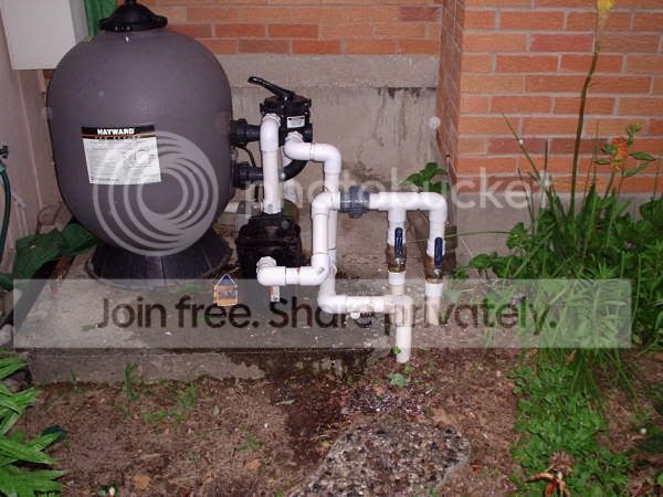

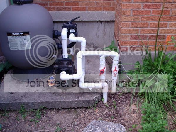

I did replace 2" valves recently on one system that the customers were leaving to go on vacation so I knew that no chance of water going through it would be possible. Here's a couple pictures.....hell let me know if I did anything wrong....not my forte dealing with swammin puols.

Nice valve job. The owner must have bought a "contractor pack" of 90s, and was determined to use every one of them. (Why use a single 45 when 4 90s will do, after all?) Only question is -- what's the big puddle of water doing in the "after" picture?

The water was from releasing the pressure from that lid that you can see into to remove dirt/debri. If I would of waited 3 more minutes after taking that picture, a huge storm came in and made everything soaking wet.
I need to photoshop my pictures better to hide the water spilled around what I work on/finish. I can't stay long enough to allow the water to dry and then take a picture.
Those 2" ball valves were $38 a piece.:eek:

Where you put the new and too expensive valves... isn't that the suction side of the pump?
If so, what is the line before the union feeding, and how? Or am I wrong and the pump is being fed pressurized water? And why is the new valve fully open when the original wasn't, you change the flow rate? What was the reason for replacing what look like good valves? Assuming they were bad for some reason, I would have proposed and used PVC ball valves because of what pool chemicals do to brass and SS valves.
The customer had that entire system reworked 2 years prior and she had 2 - 2" gate valves that worked for 30 plus years since they are turned on and off weekly/monthly. Like I said....don't know enough about swimming pools to know their operation. The installer insisted that he use those PVC ball valves because they are cheaper. Within those 2 years those ball valves hardened up and broke the left side valve.......the reason why the tab is slightly turned. I couldn't even turn the right one. I couldn't readily find 2" gate valves like they had (which was really unusual) and told them that the ball valves will give a better reliability than plastic. If you look at the pictures.......you'll see that supposedly the "pro" used DWV fittings instead of pressure fittings and had those two pipes stressed coming out of the ground. When I reworked the system I used all pressure PVC fittings, nothing was pulled/stretched into position and I installed that union so I can somehow divert some of the vibration coming off of the pump.
If so, what is the line before the union feeding, and how? I don't know the answer to that one.
Or am I wrong and the pump is being fed pressurized water? Don't know
And why is the new valve fully open when the original wasn't, you change the flow rate? Plastic ball valve is broken
What was the reason for replacing what look like good valves? Broken and slowly got hard to turn. They are aware of the possibility of the new ball valves doing the same but will surpass two years I'm sure.
Assuming they were bad for some reason, I would have proposed and used PVC ball valves because of what pool chemicals do to brass and SS valves. They requested gate valves since 30 year reliability over a brief 2 years was enough reason to switch.

To azkyle: Can you see that big black valve in RUGGED's photos. There is a position on that valve that says backwash, you position the valve there and turn on the pump. The sand is backwashed out of the filter and comes out that vertical pipe (that you can barely see) on the backside of that valve. People generally hook a flexible hose to it and just just let it flow somewhere in the yard.
You add sand to the pool skimmer box (with the pump running and that black valve in the filter position) to replenish the sand in the filter. You can add a union if you like, but it's completely unnecessary. I can't see the filter connections in your photos but there are probably unions there to remove the filter for winter storage. I can see the unions in RUGGEDS photos right next to the filter. Your filter is probably similar. The pump can stay outside, as long as all the water is removed.
To Gary: That looks like a pretty standard pool installation. Yes, the two valves are on the suction side. One line probably comes from the skimmer box and one line from the bottom drain. If you vacuum the pool with the vac hose hooked into the skimmer box, you shut off the bottom drain to get max suction thru the vac. If you're sweeping the pool toward the bottom drain, you shut off the skimmer box. Most of the time they just stay fully open.
The other line going into the ground (the one with no valve) is the return of the filtered water to the pool and probably splits into 2 lines that dump water into the pool (one at each end) at the wall.
