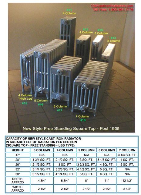

I have chosen this style of radiator for my home and I'm trying to figure out the right one for each room.
Does any one know how to convert the displayed numbers into a BTU output?

Note for hot water, the above chart says "AVERAGE water temperature" - midway between supply water temp & return water temp - NOT "supply water temperature".

The heat loss across those rads would be entirely dependent on the system you have installed. IE the flow rates and working temps of the water.

Calculating total BTU output for the radiators
Thanks for the information guys.
The chart is excellent - I can get a pretty good idea of the size now for each room and will leave the exact measurements for my engineer.

Working on the BTU output for a 3 column radiator
Working off the Standing Radiator Heat Emission table above and the information from Burnham I came up with these calculations.
A 3 column cast iron radiator (as shown above) 32" tall x 4 3/4" deep x 25" wide totals 32 1/2 square feet. With a water temperature of 170 degrees Fahrenheit the chart show I get 150 BTU's per hour per square foot.
I have checked my math and this works out to the above unit producing 4875 BTU's per hour. This is fantastic as the standard base boards that are cheap and easy are only producing about 760 BTU's for the same foot print (2' linear feet).
I will send my specs to Burnham and they do all this calculating for me. I am trying to use as many of the cheap baseboards as possible and make up the missing heat with the column radiators.
If I have them painted white which I most surely do the heat output will be affected as I have read. Even if the painting drops this number by 10-20% the unit is still cranking out huge heat in a small area!
