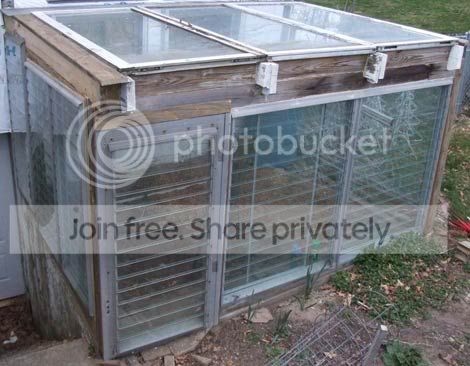

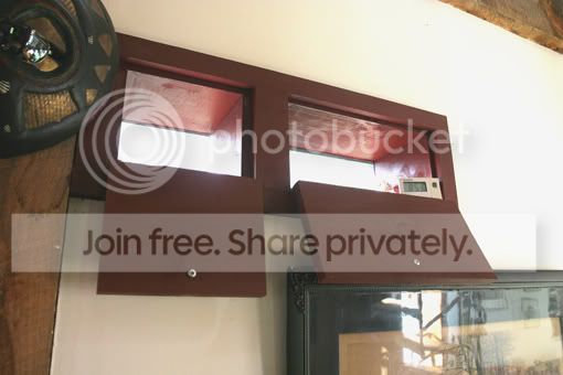

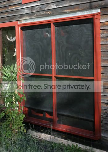

My greenhouse was up to 105 the other day, just about 70 outside. I was bumming that I didn't have the solar heater built yet
I'm building a can-0-later air heating system
Air heats up faster, but cools off faster
No mechanical moving parts
The greenhouse cost me $30 to build
The solar heater will be about the same
This is one someone else built
The air coming out the top in the winter is 85.3

Actually the doors get shut when it gets colder outside
The person who built it has someone (wife) who is home during the day.
Most solar systems properly built will work
Its just a matter of finding the right design/setup

One of the shows on TV went thru a solar hot water installation
The storage tank was around 1200 gallons & was in an insulated space
My greenhouse has been up over 80 since before 9a
Right now it is 85
So since before 9a I could have warm air flowing into the house
If I had to wait for water to warm up it would be longer
But it depends upon your storage capacity
