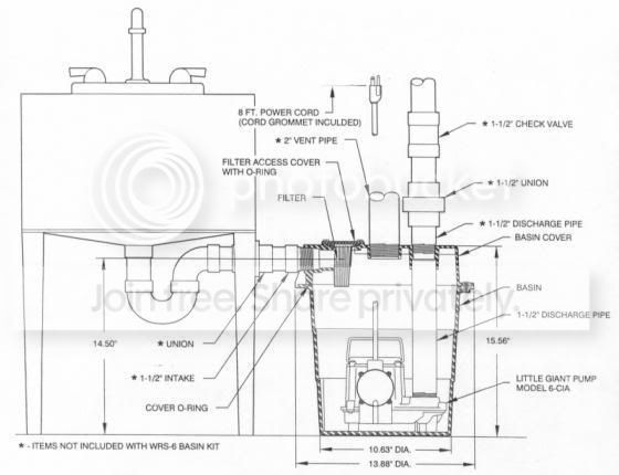

I installed a 2", ABS P trap in a drain line and now have doubts about its orientation. The trap has a sweeping entrance and a 90 degree entrance. Which one should be the outlet ? How much difference does it make if I got it wrong ?

The trap should be installed like the one pictured here, the trap arm the longer piece. The trap should also be installed directly under the fixture its' serving.
Where did you install the drain trap, post a picture?

Both OK
The incoming should be the long sweep and the 90 is the outlet as exampled from manufacturers literature. However it does not seem to make a difference as some have been installing the sweep on the outlet side.

cursive u
Thanks for the picture. In the picture, the trap is a symmetric, u shape. The trap I have is like a cursive u where the u starts with a vertical bar and ends with a sweep. Both sockets of the trap are vertical but the tube leading to one socket is vertical and the tube leading to the other socket is at an angle (sweeping).

OK, thanks. I was trying to figure out if it made a difference for siphoning from the trap or something.
