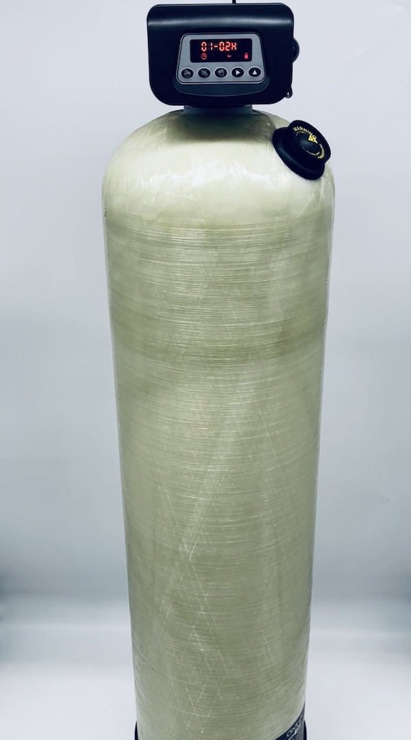

To eliminate needing to periodically remove the control valve to refill media, a tank utilized for Acid Neutralization, will usually be equipped with a separate Fill port located on the upper dome.

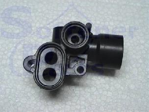

@Reach4 - Replacing the injector body sounds like a very good idea. I didn't realize it wasn't part of the main housing. Thank you!

At this time, I've got a new no-brand 5600 and a new Fleck injector body on order. When they come in, I'll decide which way to go and return the unused stuff. Right now, I'm leaning towards the new injector body, just for the peace of mind. I don't want to repair this again next year.

The new injector body arrived. I spent a few hours the morning installing it. It was a bit messy until I realized that there were three o-rings to swap. :)
I also put a hose clamp around the injector body, just for a little extra safety. It's barely snug, not tight. Same for the discharge port nipple.
