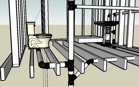

    Here is what I have so far.
    Question 1) Are these the correct connections? Shower drain is 2" and picks up the sink drain which reduces down from 1 1/2". Shower vent and sink vent are both 1 1/2". Question 2) Does this need to go to 2" when they combine? Toilet drain and main stack are both 3". Main stack is new and will run all the way down to the basement and tie into the existing stack. Let me know if you need clarification on anything.
    I'd also like feedback on the wall framing. I offset the wall the sink is on because otherwise I would have a joist in the way of the sink drain and shower vent. Is this necessary or is there a better solution?
    Let me know if you need to see other views.

    Nice drawings
    Everything else looks good, what's the distance from toilet to vent?

    Should be less than 6'.
    Few more questions:
    1) Is the combo necessary for the sink drain, or could I use a sanitary tee?
    2) Does it matter if 90 degree drain elbows are short or long sweeps as long as they are drain fittings and not vent fittings?

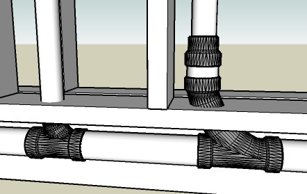

    Here is the rest of the plan for the basement run.
    Are these connections ok? If you're wondering why it runs in every direction, it's because I have to work my way around beams, rooms, etc...

    This san tee (on the left) should be a combo - no s-tees are ever allowed to be installed on their "back"...[​IMG]
    To connect the sink to the horizontal drain line, the combo is the right fitting.... I would go with a 3X3X2 with a 2X 1 1/2 reducer and make the sink waste line 1 1/2 right up to the vent tie in...
    Sweeps can be long or short - as long as they are sweeps and not regular 90s

    that 3 inch ell is wrong
    [​IMG]
    that should be at least 2 -45 degree fittings instead of the elbow
    comming off the toilet
    teh vent appears to be close enough for this state...
    the elbow will have the possibility of clogging up
    the tee should be a wye like the above fellow already said but
    everything else looks tolerable.

    If it is a long sweep elbow, there is absolutely nothing wrong with it and it will not have any more problems than two 45's would.

    Since you CAN draw so well, Nelson, (congratulations) draw all your sweeps as long when the direction of the output is horizontal (water flowing flat, not downwards). First one is that toilet. And there, you could even draw a single 45 and let the SanTee be pivoted by 45 degrees to meet it. Since you have to strengthen the joist anyway, it won't complicate your real work at all to drill a hole that lets the pipe go through on a 45 degree angle. Drawing it that way might be a challenge because you have to swivel the SanTee by one eighth and that may be hard to manage in your software.
    Under the shower, swivel the P trap so its output faces the wall, and put its output into a long sweep quarter bend (90). Water coming out of a P trap won't be confused by heading sideways. Then from there you have one long straight line with NO bends. This eliminate two bends. Very smooth and efficient. This is to follow the same principle as what people told you in your previous thread about the toilet run. No need to make a pipe zigzag; just shoot it out in one direction first and put only one bend in it to meet the target, and only a 45 if possible.
    So, re-writing what I just wrote, shoot that PTrap output over to the wall to meet it at a 45 degree angle and use a 45 bend. (See, anyone can get confused about how to optimize a system. It wasn't immediately obvious. duh.)
    Use a combo for the vent. As mentioned.
    Under the bathroom, use a long sweep in at least two places, i.e. where water is being directed from a downhill trajectory to a horizontal one. Thw would be the first and the third of the FIVE bends you have drawn before the Wye. If anyone contradicts me about this last point take it seriously. Configuring multi storey DWV is not something I do.
    Your drawing skills are the best. Your understanding of what you are being told is high. Your reacting to what you hear is good. You are an ideal DIY for people to interact with. Thank you for making it so enjoyable!

  11. nelsonba
    nelsonba Member
    Joined:
    Sep 28, 2005
    Location:
    Minnesota
    Forgot one thing...
    I'm also relocating an existing cast iron vent that services something on the floor below (not sure what). Can I tie it into the new system like this (First Two pictures) The reducer changes the 1 1/2" vent from the sink/shower to 3", which is what the existing vent is.
    I've also attached the changes to the shower drain and the shower vent.
    markts30:
    Shower drain is 2". Why would I use a 3x3x2? If I can find a 2x2x 1 1/2 combo I'll go with those for both the sink drain and the shower vent.
    I'll plan to use long sweeps for the horizontal turns as well as the change from vertical to horizontal in the basement.
