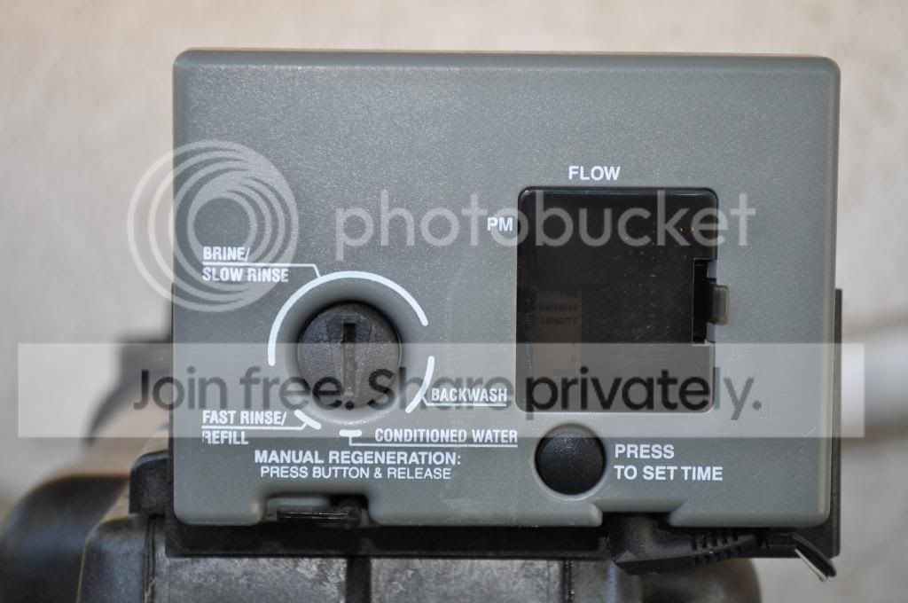

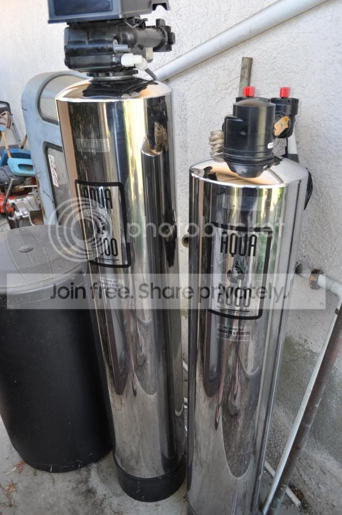

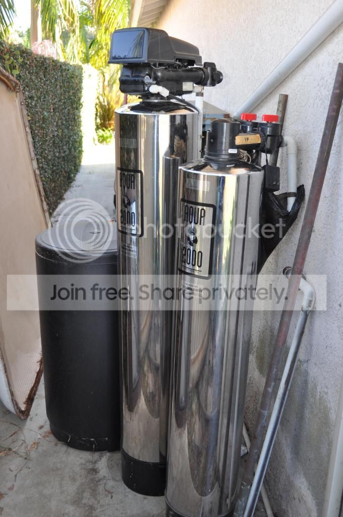

    First off Hello to all from Los Angeles CA. I have been browsing the threads and found a ton of useful information for my newly acquired water softener system install. A buddy of mine lost his home but prior to that offered up his 3 year old water softener system. I went ahead and took photos of it installed hacked away at pipes and re-sweated.
    Now comes the fun part , the install. Ive got almost all the parts needed to get the install completed, I project about 5-6 hours by myself with no help or major hicups, but who knows with little ones it may very well be a week long project. I know how these devices work but am no expert by any means and contacted a local water softener company to get a quote on a service as my buddy said it was up for service. The representative came out and did his spiel to try and sell me a new system which I politely thanked and refused. He quoted his company could do the service and start up of this system for $380.00. This seems a bit high for what is done, or is this a reasonable price?
    [/B]The only question I have on the install is the use of bypass valves. I see there are valves on the inlet tank but would these suffice? I've read about the stagnant water which can build up when using certain types of configurations with the ball valves, such as when they are used in an H configuration? Ive seen some by-pass valves which if I can locate locally I will utilize.
    [/B]
    I have posted photos of my bling bling system and brine tank, along with the by-pass valve I would like to use. It will be placed outdoor under a 3' 1/2'' overhang which should protect it rather well against the elements and the 12" of rain we get a winter here.
    Im having trouble uploading photos, I will try something else on a follow-up post to this thread.
    Thank you all, any suggestions or ideas are always appreciated to make this install and restart as smooth as possible.

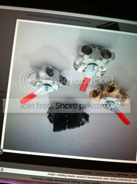

    I'm thinking this valve would be ideal.

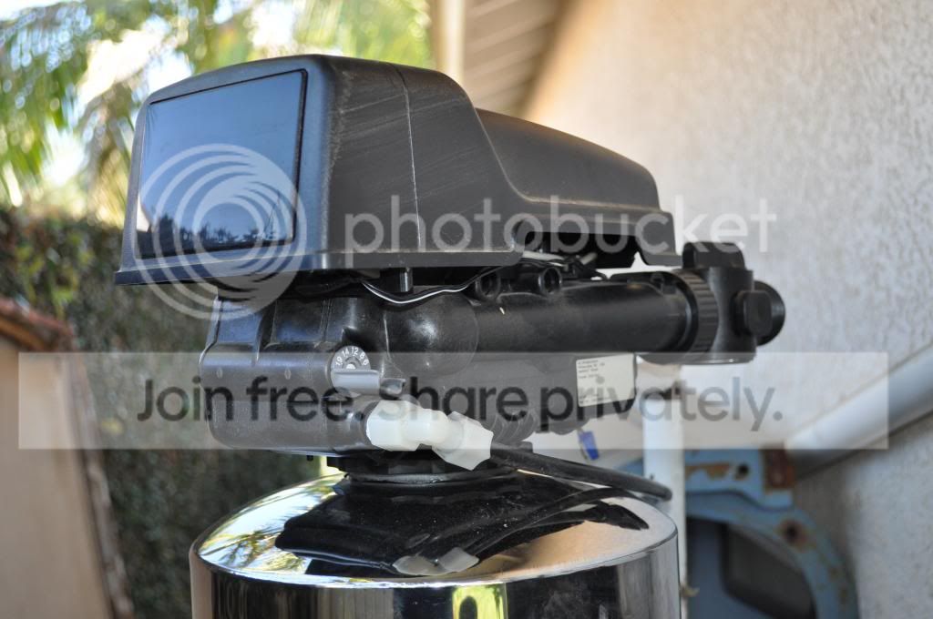

    You have an Autotrol valve and need their by pass valve for the model valve you have.
    The other piece, a filter, has a Clack in/out head on it with its own by pass valve. And yes, use the make/model specific by passes rather than building a 3 way manual type.
    The picture of by pass valves is of Fleck by passes and you can't use any of them.
    Sorry, I now see the Autotrol valve has a by pass valve on it....

    The bypasses you posted are not compatible with the system you have. Those are Fleck bypasses, you have an Autotrol valve, and a Clack In/Out head. Both units already have bypasses installed, so you could simply install the units after getting the proper plumbing connectors specific to thoe valves. What type of plumbing do you have? The plumbing connectors are relatively common.

    Type of plumbling? Do you mean pvc or copper? Im using copper, excuse me as to not understanding your questions i'm not a plumber by trade.
    As suggested I will cut out the by-pass I intended on using and start putting this thing into place, and fire her up. OOPPssss, what do you suggest on the service, should I let this company do the start up/service and then for the years to come as I learn it, complete it myself or is the start up/service simple?

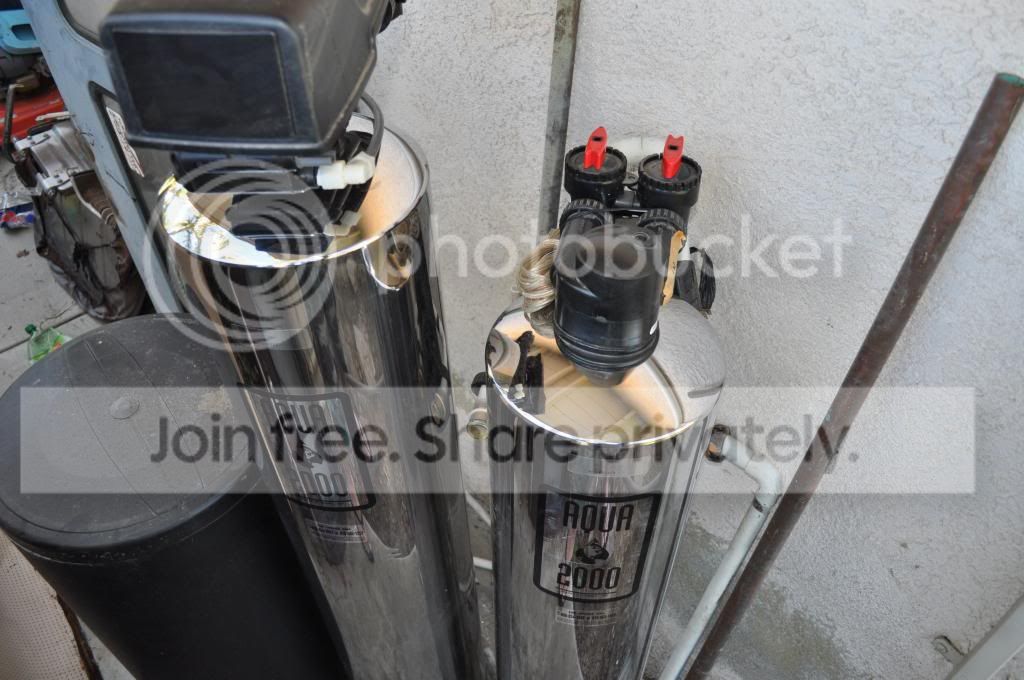

    In the pictures, both units have the bypasses already. Each unit should have a bypass, and they do.
    Yes to the type of plumbing. Both units have plumbing connectors available in copper sweat type. Be sure to consider code as to the electrical ground. Both of these bypasses will break the plumbing ground. http://www.pure-aqua.com/product_fi...263-268-Performa Cv Owners Manual 1228354.pdf Here is a link to a manual for a similar system. It uses the same plumbing connector.
    The Autotrol is part # 1001670 for 1" sweat kit.
    The clack connector for 1" sweat is V3007-02LF,
    Hope this is helpful.

    Those pieces are still on the old plumbing if he/you didn't cut them out of the plumbing... If they were cut out, which would have to be done to put the plumbing back together to get water into the house, they should have come with the equipment. So ask the seller where they are.

    I did the cutting and have everything that was there when installed, I will post a few more photos and see if anyone sees anything that I'm perhaps missing, they say vision is first to go...
    Also does anyone have information on the service for these tanks. They have been stores indoors but out of service for almost a year in half or so. Like I noted in initial post local company wants $$$$ to service.

    Wait I have both these fitting attached as they sit, so this is resolved and install can move forward.
    Now if I understand correctly, the electrical plug is a simple plug in and that's it, the ground is already on attachment.
    Cheers
    Marcelo

    Ok Gary.
    I actually hacked the piping down below far from the inlet and outlet at the valve, so I won't have to worry about anything melting.
    Is there a manual available to assist me in the programming of the control valve?
    And finally how do I know if the tank requires resin, or should I replace it since the tanks have not been services in about 3 years and been out of use for over a year?
    Thanks Gary, I appreciate the information.

    You should find a manual for your model of valve here;
    www.gewater.com
    I would install the unit and add 5 gallons of water with a 1/2 cup of non scented regular bleach to the salt tank and then a bag of salt and do a manual regeneration. Then see how the water is and if it is soft and go from there.
