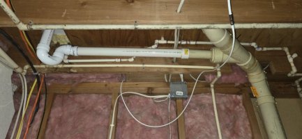

I recently had a bathtub-to-shower remodel done by a national company. I think they did a great job. But I'm having issues with the shower p-trap getting sucked dry after 3 toilet flushes. The shower is in the 2nd floor bathroom. There's also plumbing in the basement.

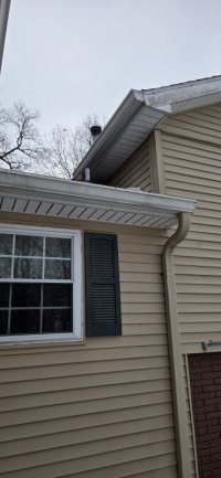

I've also been up on my roof last summer and ran a garden house down it when I was concerned that there might be a dead bird or leaves in the stack. But the water never backed up. And with no water anywhere in the house, I'm assuming it was working properly.
It's a small stack that's on the lower level of the roof. The upstairs toilet and shower are quite a bit higher than the vent stack is. I have no idea how it's all connected. I also have a basement toilet and sink, along with the washer and water softener. There's no issue with any water backup from any of that.
I've attached a photo of their drain work. My old P-trap was lower I believe. I'm also showing the only roof vent stack that's above my kitchen window.
Question ... do you see any issues with the height of their P-trap in relation to the toilet outlet? Should it be lower to keep more water in the trap?
Or is there another issue concerning the venting?
Be kind ... I know the water line plumbing behind the toilet outlet looks like crap.
