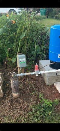

I recently installed a vertical 86 gallon AO Smith pressure tank on my submersible well. Everything looks great, new plumbing and no leaks! Did it right the first time or so I thought! The problem I am having is that it appears that the tank only fills with water to 1/5 capacity (based off condensation line on tank - see pic). The pump only ran for approximately 2 minutes before it cutoff. I verified the pressure switch cuts in correctly at 38 psi and out at 60 psi and the pump works like it should.
Here are the details:
1. Verified No Leaks
2. There is a new 40/60 pressure switch and confirmed cut in and out.
3. 1" water line from well head to tank to the house
4. Submersible pump is wired for 240v
5. Verified 38 PSI on tank
There is great pressure inside the house. I understand that the tank wont completely fill with water, just thought there would be more that what's currently showing. I have bled the water line to the house by opening all the valves and then closing to see if the tank would fill up more but it did not.
What am I missing? Thoughts / Suggestions?

The control box in the lower left of the photo should provide some information on the pump. Also, post a photo of the wellhead to determine if pulling the pump can be tackled by hand.
TW80CJ5
21
Florida
I just had to replace that last week. The other one was full of dirt dobbers and various debris. Its for a 3 wire submersible pump and is 1HP like the previous. See the photo for the well head. Thanks for the help!!!

In my area a well like that has a pump hung on galvanized pipe, you may need that trackhoe to elevate for a look.
