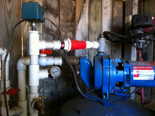

  11. justwater
    justwater Well Drilling/Service
    Joined:
    May 13, 2010
    Location:
    FL/GA
    [​IMG]
    heres a basic install of a plastic CSV on a 1/2hp pump (yeah i know, no conduit but its used here on the farm.. sue me). all water from pump must pass through csv first before it goes to tank or anything else, and switch must be after csv or it wont work. you could leave the switch attached to pump, but would need to unhook switch line from pump head and plug hole, then run a longer line from switch to a fitting after the csv (i prefer moving switch). disregard the cut-off valves on the pump's suction, the well is artesian and free-flows like crazy. i'll let the others answer your questions, but thought this might help you get an idea.

  17. justwater
    Joined:
    May 13, 2010
    Location:
    FL/GA
    No prob. Glad u went for the 19gal instead of a tiny tank. the pump in the pic is sitting on a 19-20gal.. works great. Let us know how it turns out!
