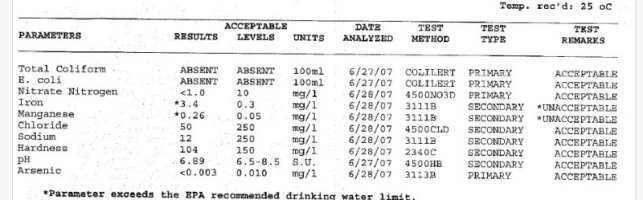

Hello Everyone,
My water has a hydrogen sulfide problem that started this winter. It has gotten increasingly worse as time goes by so it's time to take care of it. When it first started, I assumed it was my greensand filter because it was not sucking in the PotPerm as it should. After replacing the float system in the PotPerm tank, and replacing the Fleck 2510, the solution was drawing correctly during the backwash cycle. Immediately afterwards, the smell mostly went away. Thought I’d had it fixed.
It was good for a while and now it’s back, stronger than ever. The smell still seems to vary with regeneration but never goes away. It was very mild this morning, but awful yesterday. Both the Greensand and Softener regenerated last night. They are usually staggered but once in a while they both run.
Time to ask the guys here!
My well information:
  • Drilled well is 18 years old. I’m the original owner here.
  • Never had H2S issues before this year
  • Only performed the initial sanitize (bleach) when we installed the well 18 years ago.
  • The water is nasty with iron. If I put raw water in a bucket and leave it, it goes brown with an oily looking surface.
  • Well depth is 480 feet
  • 6” bore
  • Only about 5-10 feet of casing if I recall. Nice rocky New Hampshire lot :-)
  • Pump is dropped to around 450 feet
  • 6 GPM
  • Static level originally about 30 – 40 feet from the top. This past month water is pushing out of the top with all the rain we’ve had
System Information:
  • Water treatment (in order)
  • PH Neutralizer 10x54 tank with Fleck 2510 valve filled with Calcite and Corosex at 2:1 (Raw water about 5.5 ph) re-bedded about 2 months ago. Ph now around 7.0 I think its on a 3 day regeneration cycle.
  • Green sand 10x54 tank, Fleck 2510 valve. Pot Perm for regen. Regenerates every 2 days
  • Water Softener 10x54 tank, Fleck 2510 valve with salt brine tank. Regenerates every 3 days
  • Activated charcoal up flow, 12x36 tank, no valve
  • Big Blue spin on particle filter
  • Original water test attached as JPG
I did some reading on the forum yesterday and found the popular Moravec procedure to disinfect and figure that is a good starting point. But I really want to have a logical process to attack this issue. So where should I start?

Disinfect with the Moravec procedure first? (Reach 4’s post)
That one. Include the WH and the softener (limiting the bleach to the resin) and tanks. Include all of the piping.
Order pH and chlorine-measuring stuff now. Figure where you will dump the sanitizing solution to minimize killing plants and bacteria in your septic. You may want to buy or borrow extra hose. Be able to get more vinegar and bleach, because they get exhausted. You will not be able to compute how much you need.... They get consumed while doing their jobs. Prefer bleach without the laundry additives. Chlorox says to not use their laundry bleach for sanitizing, and sell a sanitizing bleach. I get my bleach from Aldi. I get my vinegar from Sams.
Also check if H2S may be being generated in the WH. Sanitizing the WH and other pipes will help that. But you might also consider switching to a powered anode.
I don't think you or your neighbor should put a dry well near the property line, unless this is a joint venture.
I really don't think that his dry well is likely to be contaminating his your well. Can you put your used sanitizing solution into his new dry well? If your driveway were big enough, you could use that. Otherwise use the weed-filled ditch.
