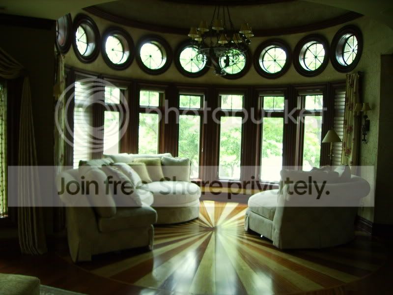

A near miss...just like hand grenades & horshoes
This is our friends house: (ours is tiny by comparison)
Ian Gills
Senior Robin Hood Guy
2,743
USA
That clearly was not built by a licensed professional.
Someone has taken time and care with that construction.
