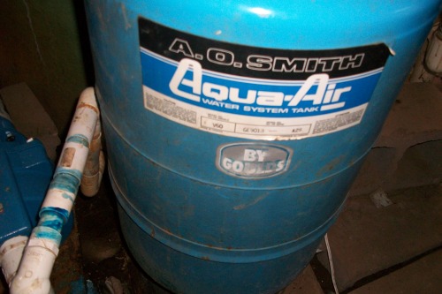

In the continuing saga of my bad luck, after replacing my compressor/motor with pulley wheels that brings the water up into the cistern and the jet pump that pumps the water out of the cistern and to the house (had to replace that twice because I got a piece of garbage Countryline pump that died in two months-- cracked a rod in the piston), the pressure switch on the pump kept flashing and shutting off and it turns out the pressure tank went bad.

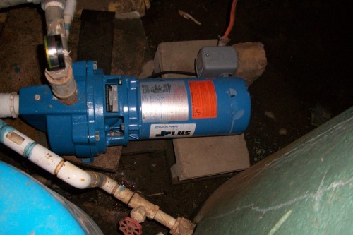

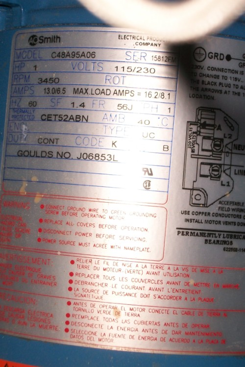

I have a Gould pump-- which I believe ins 1HP but I will have to check the documentation or see if any markings on it indicate that information before I can say for sure.
I'm not sure what exactly the size of my current pressure tank is. I just know that it has been in place for over 10 years (possibly longer since I don't remember ever having it replaced but I didn't pay too much attention to such things before it became my responsibility to call for repairs and make sure things got done).

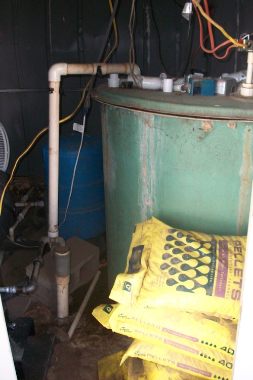

Here is a photograph of my pump house. You can see the existing blue pressure tank to the left of the ugly green cistern. I don't know what size that is and don't know if there are markings to indicate, but I'll have to go look.

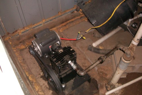

In the lower left you can see the metal pipe coming out of the compressor and going in to the ground. The wires to the float lever attach to the compressor (I think its called a compressor-- its two parts-- a motor and compressor and it has two pulley wheels).
Here is my Gould jet pump (I think it is 1HP)

He wants to replace my current pressure tank with a fiberglass one and I'm not sure that would be better. I'd be afraid it would rupture and I've had other people say it isn't good.
So, now I'm trying to figure out what to get because the current tank was only fixed temporarily and I don't know when the guy is coming back or if he was able to get the fiberglass tank already.
I saw something about CSVs (Cycle Stop Valves) and was wondering how those work and if that would be better than just getting a new tank. The local Tractor Supply only carries countryline brand and I am never going with that one again after that jet pump problem.
Someone recommended Zilmet, Flexcon and Well X Trol brands; but I didn't see any place that sells those.
Is a CSV less expensive? If it would be more efficient and cost effective, where would I find one and what parts would I need to install it or have it installed?
Is the CSV in lieu of a tank or in conjunction with one?
