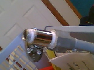

I am redoing our kitchen and in doing so I need to change some of the plumbing under the sink. I've got all the new cabinets in and am trying to get all the plumbing I can get done before the countertops are put in.

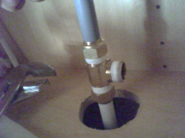

My problem is qest pipes. I have two leaks that I cant seem to figure out how to fix. The first one is at a T (pic1&2) and the second is at a shut-off valve for the dishwasher (pick 3).
At some point Im going to replace the piping for the house but for now I just want to stop the leaks. Please help.

Well the best solution would have been to repipe the kitchen properly as part of your renovations. It is clear that you are not into sweating pipes or installing pex yet, but that is what I would have done. At this stage to get the water back on I would recommend installing this type valve and consider doing it properly soon.http://www.watts.com/pro/_productsFull_tree.asp?catId=71&parCat=442&pid=5315&ref=2
It is a push on connector that will go on the Poly-Butylene and adapt to a faucet/dishwasher/icemaker/etc. supply. It will certainly work better than what you are trying.
I would also recommend installing braided stainless steel supply lines.

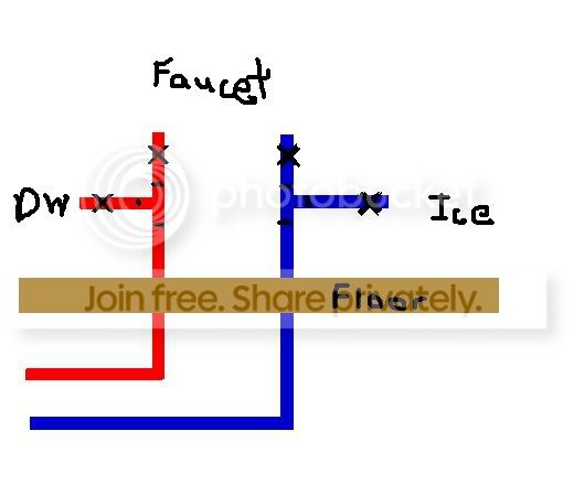

I'm guessing your supply pipes to the kitchen sink are configured something like this picture below... With supplies cut in to whatever appliances you have.
What I would recommend replacing from the basement or crawlspace (hopefully, a slab becomes much more difficult) up through the floor and under the cabinet with the material of your choice either Copper, PEX, or, CPVC and supplying whatever fixtures/appliances you have. From the stop valves to the fixtures/appliances use Braided Stainless Steel supply lines. (Do not use the Flood Stopper type)
Transition from whatever material you select to the existing Poly-Butylene supplies by using Sharkbite couplings. http://www.cashacme.com/prod_sharkbite_pushfit.php

Heres what I've decided to do. The compression t fitting Im going to remove and replace with a sharkbite t fitting. Then I bought cpvc to go up to a valve for faucet supply and cpvc to another valve for dishwasher supply. The valves I bought are for cpvc which are cemented to the pipes as you suggested.
When I redo my pipes Im going to use pex as I have read it is better for my climate. Sharkbite would be awesome to do for connections but at almost 5 bucks a shot I may just use the clamps.

You are not supposed to use tape etc. on compression fittings. Same goes for the QEST nuts, you tighten them until they squeal and a 1/8 to 1/4 turn and quit. Also, the nuts are not NPT, they are straight; that's for both QEST and compression.
So do it right with no tape and don't over tighten either type of nuts.

Well I did it a couple of hours ago. I must say I like the sharkbites. It was a sinch. I got everything hooked up and no leaks! Thank you for your help.
