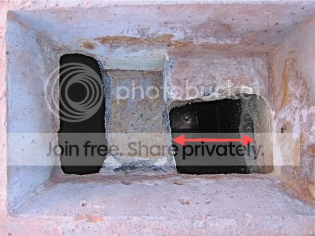

I would love to do that, but I have no outlet tee, just a flush-to-the-wall outlet pipe. And as you can see from this straight-down pic, there is no room in the cast concrete output "chamber" to put in any kind of fitting, far less a filter unit:
In fact, a straight piece of 4" pipe won't even go down that hole ... only a 3" pipe, and that's with no fittings coming off the 4" output pipe.

Again, as I indicated above, I would really like to have a filter or at least a sanitary tee on my tank output, but it's unfortunately impossible due to lack of adequate clearance as shown in my photo.
